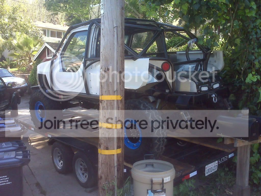

Thought I would share a most recent pic that I have of the progress. A little more has been done but no pics......yet.
Lost a bunch of wieght....it's now on its tires and off of the stands and the ride hieght is 3" taller...even after I removed zero rates from rear.
keep in mind, I am putting the floor and dash in first before I do the door bars.
I like it. I am getting ready to do mine sorta along the same lines. Got any more pictures?
