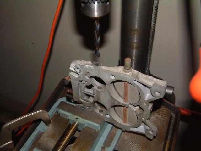

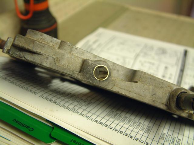

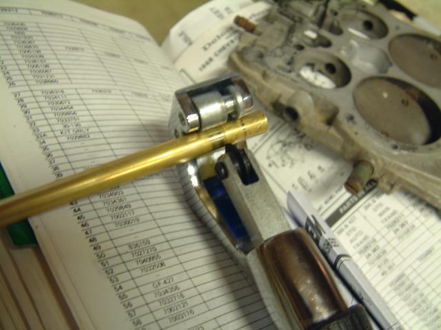

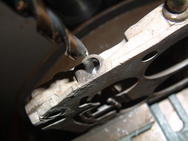

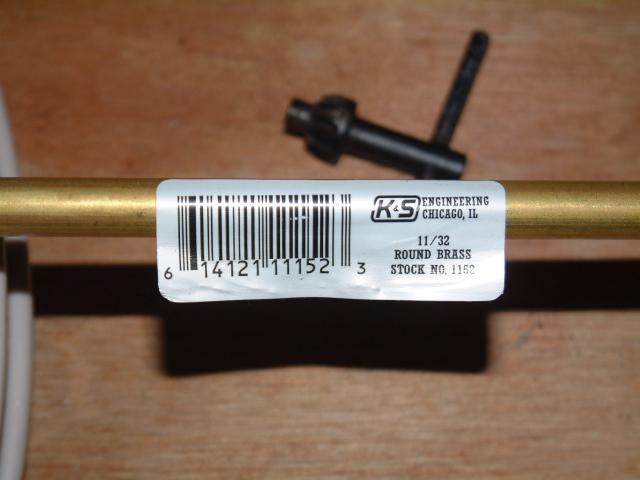

throttle bushings can be repaired pretty easily if you can have access to a drill press, can find the brass tubing show below (R/C hobby shop), have an 11/32 drill bit and some green locktite.
Here's how it looks in my garage..
the process is pretty straight forward. Disassemble the throttle plate (file away the exposed screw thread completely so you dont break them off in the shaft), setup in a drill press, use a 5/16 rod for alignment (I used 5/16 brass tubing that I bought at the same place I got the 11/32 pictured below), and drill the throttle plate. install the bushing with green locktite and reassemble.
Be sure to replace the throttle blade screws with new ones and restake them or at least use green (290) locktite on the old ones.
Cheers!
