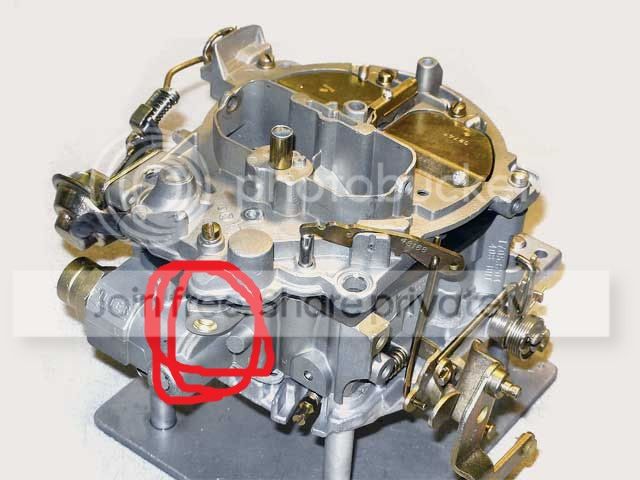

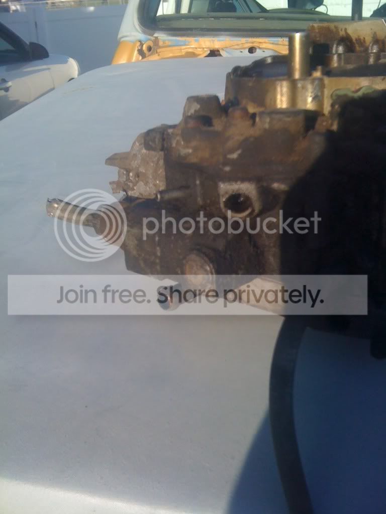

I pulled this quadrajet carb off of a 1984 chevy van.
I was looking at pictures online and noticed the fitting in the red is missing. what is that fitting? the carb number is Rochester Quadrajet 17084226 0934 H0D
Is this something I should worry about? If you look in the hole you can see that it goes back in and up I think..

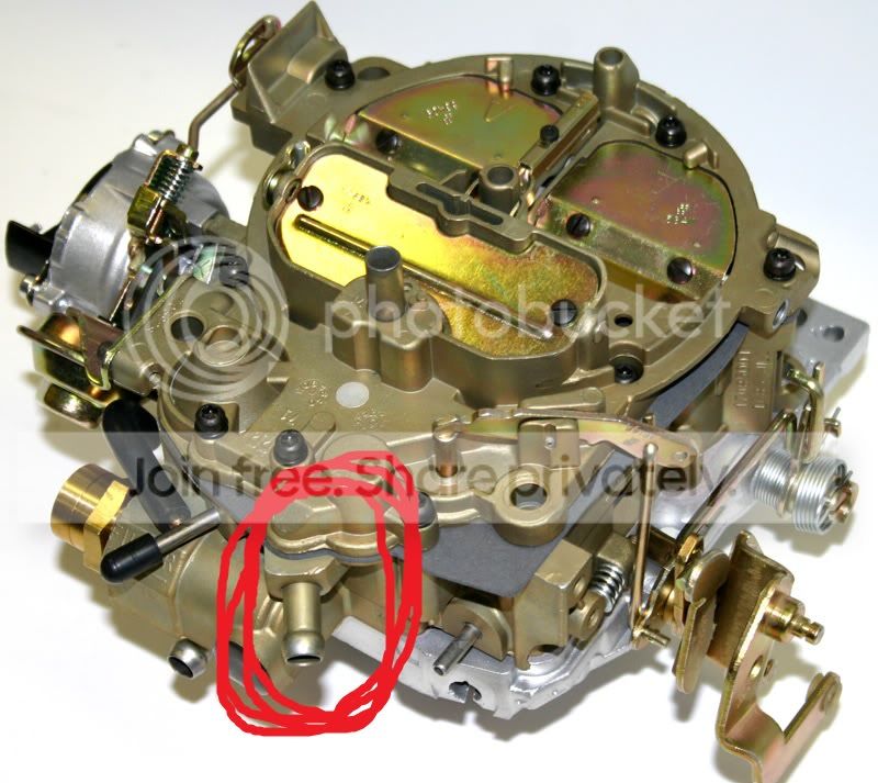

I also noticed this picture online that looks like its plugged. Could I just tap a hole and put a new inlet fitting or just plug it?

That port may have been to an evap canister hose.???

I have no idea what that is for.. When I unhooked everything there was nothing in that spot :dunno: Do you think I should look into getting a different carb?
Whats a good place to buy a rebuild kit from? I also found out that this carb is off a 305 non computer controlled. Will I need to change things like jets, rods, ect. to work for a 350?
I dont think you NEED to look for a different carb, but those books should explain what exactly that port is for...as I remember on my 85, it seemed like it was a well vent that went to the charcoal cannister for emissions purposes.

on the 78 4mc qjet that fitting went to the pcv valve. I suggest first getting a junker and tearing it apart. On my qjet I expoy the plug welds. Some say it is better to tap it but I also read by 78 it was not much of a problem as earlier ones. I went with a qjet the had a manual choke.
tap and plug it? or add a fitting and hook it up? why epoxy the plug welds? to prevent vacuum leaks?
They well plugs are on the bottom. They can leak. When I rebuilt my carb I just used some jb welkd on them. The other option is to drill and tap in a plug which is a pernament solution but I felt could cause more damage if I were to drill to deep. The casting of these qjets seams to be rather fragile. They are not solid but porous.
