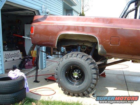

you can see the shaft angle in this pic.. I was picking up the rear of the truck along with springs.. to get factory block out.. so that is the angle of my shaft.....
