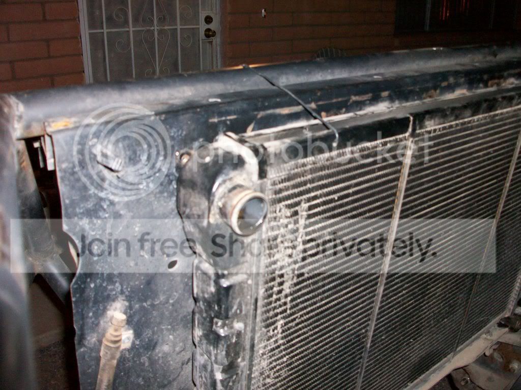

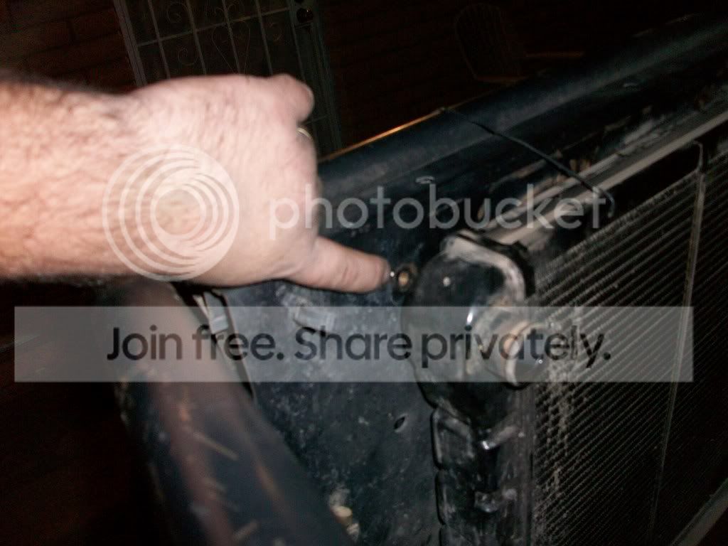

I'm in a pickle myself here , I want to put my 83 radiator which is less than 2 years old into my "new" 73-75 truggy .
Well my 83 has a tall radiator , with a bracket over the top on each side , and the plate is actually part of the fan shroud .
The truggy has holes for the short radiator , but nothing on the top . And to make it worse , the radiator is too tall for a short mount , but comes up short so I can't just drill holes and use my over the top brackets . I would have an inch between the brackets and the top of the radiator if I tried :mad:
