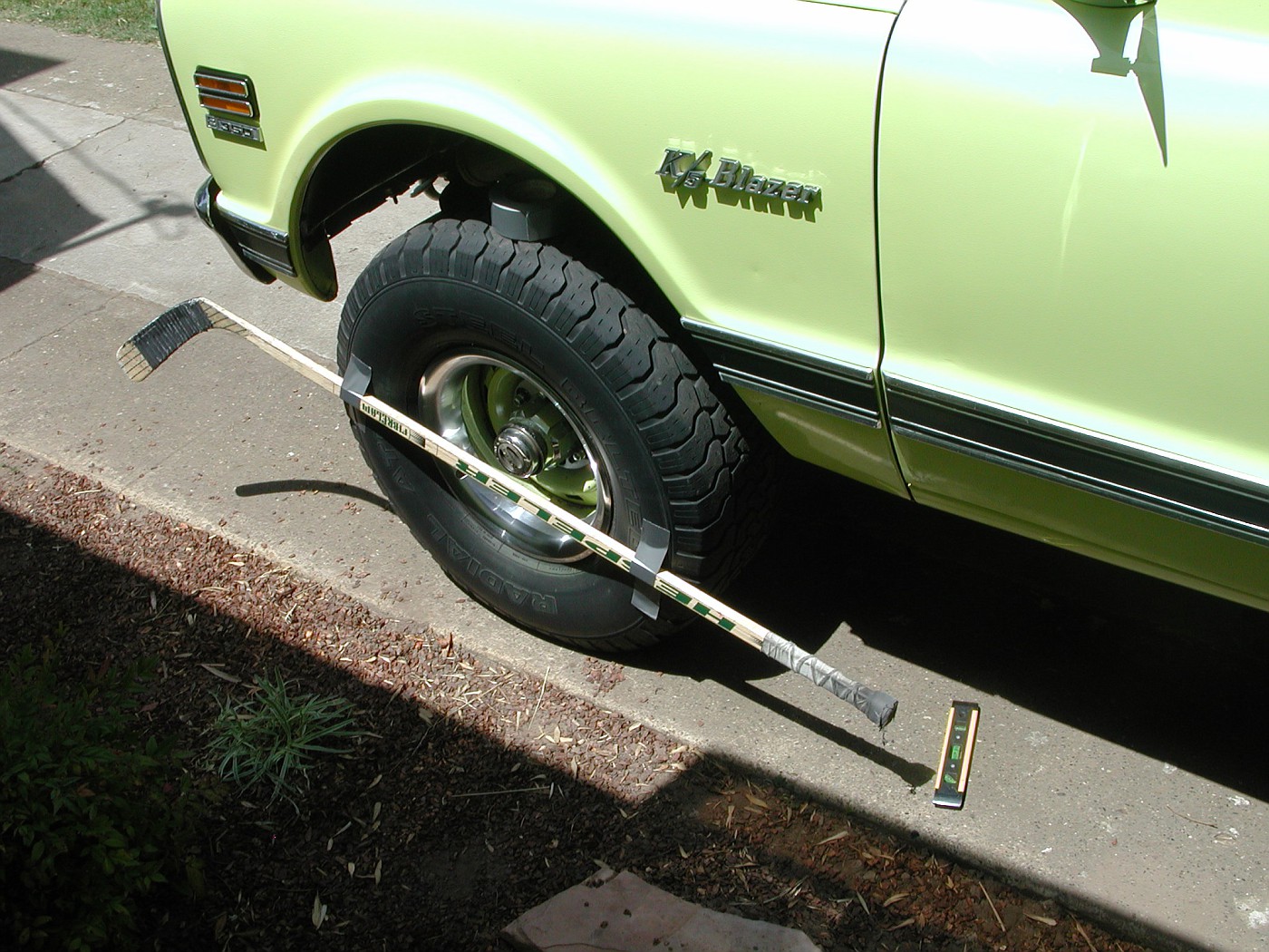

Took a measurement on my front tires to check if I was off at all.
Leading edge of tire was 82"1/4".
Trailing edge was 81"5/8ths.
Woundering if the front tire are to be perfectly parallel
or what?
Oh and this is how a Canadian gets those mesurements. /forums/images/graemlins/grin.gif

You need to mark your tires, measure, roll your tires a half turn, and measure again.
This is the accepted way to measure. Not with hockey sticks and duct tape.

Well Tim(84_Chevy_K10)I kinda like my hockey stick method but I know it's a "little" crude.
I did as you descibed.I marked my front tire with some Scott tape but then I couldn't see the mark. /forums/images/graemlins/grin.gif
I moved onto 1/4" masking tape which showed up much better.
Front measured 79.
Rear measured 78"3/8ths.
So I guess I have 5/8ths "toe-out"

Its a good method for getting your truck to an alignment shop if you wanna save your front tires.
