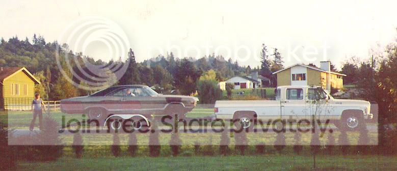

My Dad bought a '76 C20 crew cab brand new off the lot, and that truck had a TH350 (which fragged at 67,000 miles).
That pic taken in Sept 1980 bringing home my first car. :doah:
