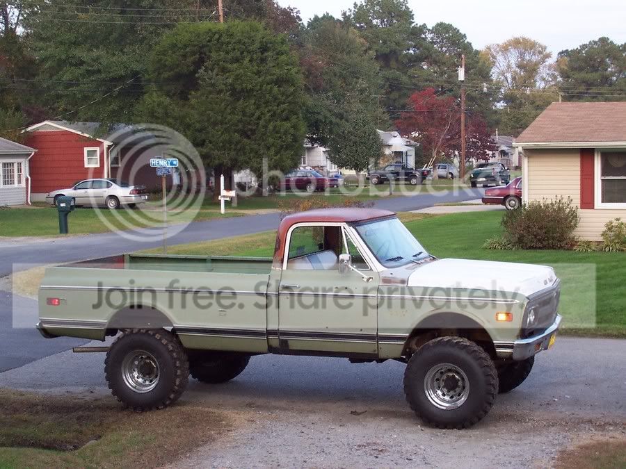

    Do you like the 71/72 body style? They would/could have power steering/brakes. Disc up front good factory ratios, the 3/4 tons were usually 4.10 or 4.56. 350 engine, SM456 and NP205. Rear factory traction aid - powr-loc in a dana60 or no-spin(detroit) in the eaton(corprate full floater). Not bad options, still some room for improvement.
    [​IMG]

    yeah those are badass.i wanted one with 1 ton stuff though. /forums/images/graemlins/thumb.gif

    A dana 60 would bolt in and there were NAPCO conversion then also. To make the rear eaton a 1 ton is as easy has swapping third members and adding 13" drums.
