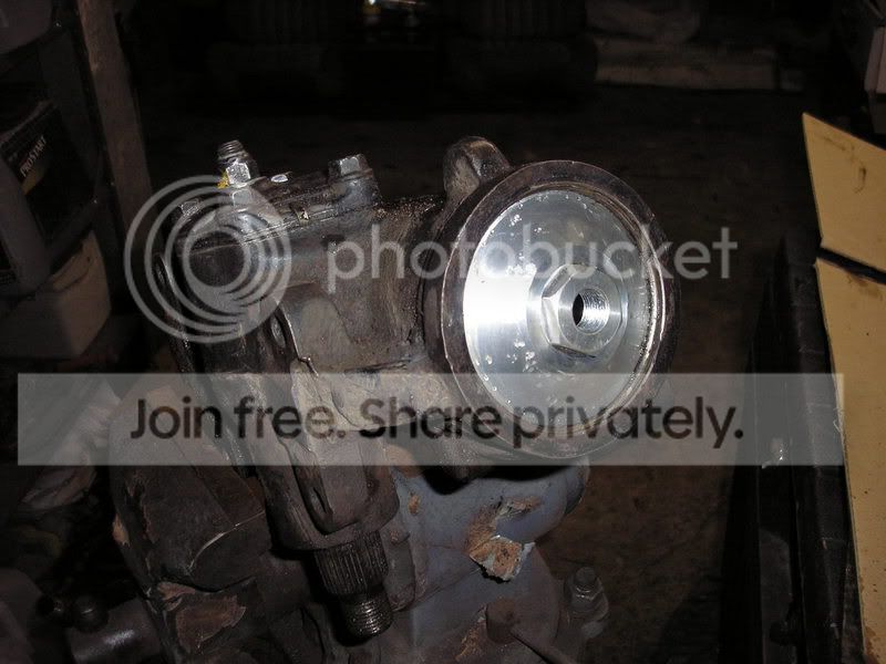

you can avoid tapping into the side of your box by tapping the top cap and buying an end cap from JKWoffroad. thats what I did.

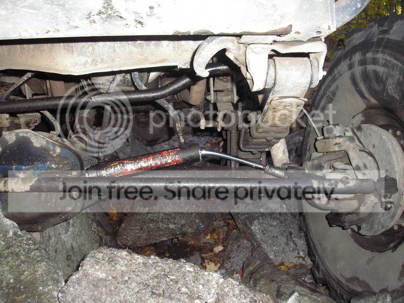

my ram is from surplus center, I have never had a problem with it. I do know a person that complained about their redneck ram leaking and another person who bent a AGR ram. both cases were due to hard wheeling.
my ram.
a smaller bent one from AGR. locked 60 with 42's was to much for it.
I haven't seen any of the end caps like that. that's pretty nice. you got any pics of the top cap and where you ported it?
my ram.
Is this the 1.5x8 with the 1" rod and ball ends on surplus center? I think I'm going to order it soon, along with the jkw cap. Definitely looks strong.
Im running a PSC ram, box and pump. The ram is 1.75x8 and I drive my truck all over the place and cant even tell its there. It's crazy how well it works in the rocks. Only complaint I have is the rod on the ram is small, its slightly bent but still works fine.
Surplus center only has 1.5 in the right size. Hopefully there isn't too much of a difference.
The one inch rod is beefy though :eek1:
