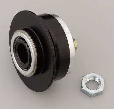

Has anybody used a quick disconnect steering wheel on a DD/trail rig? The truck doesn't get driven everyday but does see highway use and occasional street. I know of the Grant product that you can use with a Grant steering wheel but will one like this type work and be safe?
http://store.summitracing.com/partdetail.asp?autofilter=1&part=SUM%2DG7851&N=700+%2D123009+115&autoview=sku
Of course I will have to get a 3 bolt aftermarket steering wheel but....thoughts?
Not something that I would do, but if you want to do it use the best one out there - the unit from Mark Williams. There's a couple reasons for this. First is that his is the only one with an O-ring at the top of the female splines. This damps and potential rattling and puts a little load on the latching mechanism so it doesn't wobble as much as the others out there. Second is that it has one missing spline w/ a matching groove so the steering wheel only goes on one way.
Were I doing this I'd make a flange to bolt the male splined piece to a steering wheel adapter so that the turn signal canceler still worked.
Not sure what I'd do about the horn.
I have the one from Grant. Have had it almost a year without any issues. I like it and am happy knowing my truck is secure and no one can go off with it since the steering wheel is either with me or locked up. Plus a column lock adds extra security.
