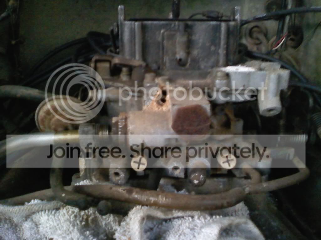

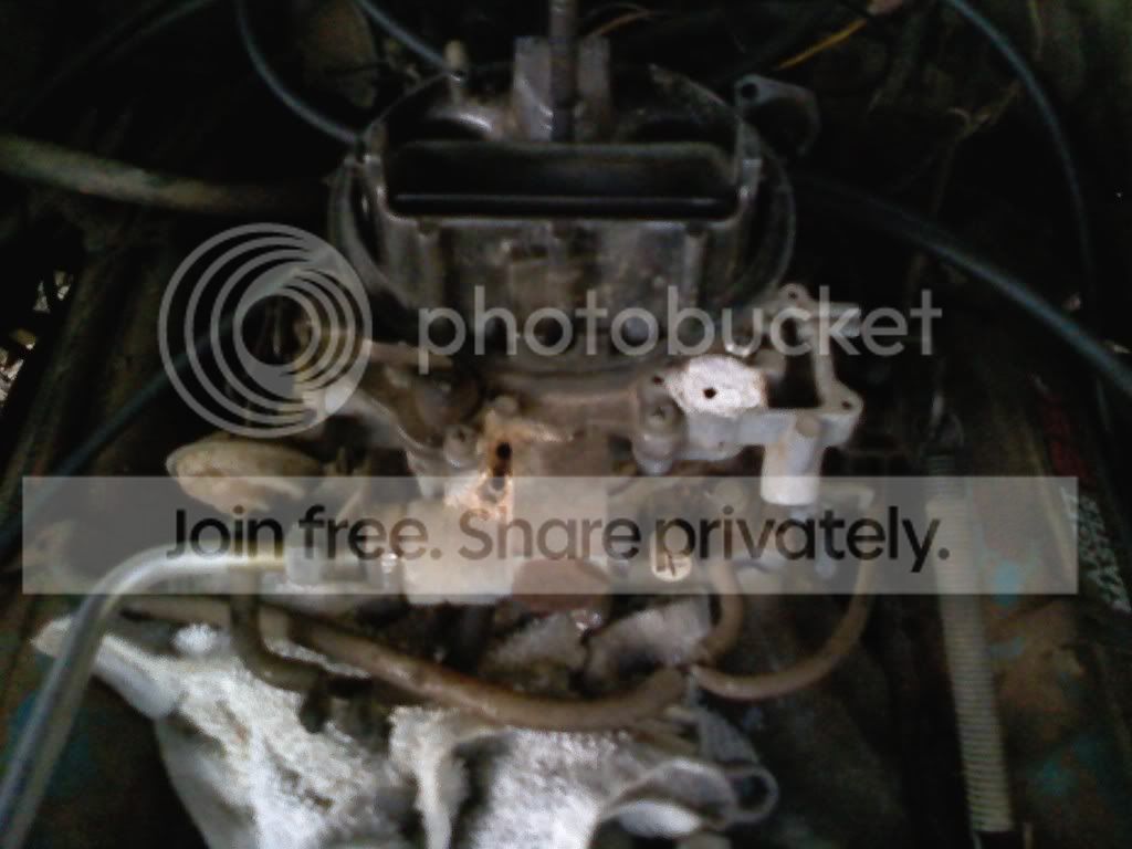

Hey, me and my dad are out trying to get the fuel system on the Jimmy up to par. Right now we're not getting fuel into the carb. Trying NOT to drop the fuel tank.
New fuel pump put on memorial day. Inline filter before fuel pump is not clogged. However we haven't changed the built-in filter in this holley carb if there is one. This is on a crate 350 installed by the PO, so we have no documentation as to what it is. Just know it's a holley.
I have verified that fuel is coming up the hardline, but it is not making it into the carb. Any help/input is appreciated guys, thanks! :D

Where did that truck come from? With all that rust it looks like it came from Minnesota.
With all that external rust it looks like the carb needs to be rebuilt and compleatly cleaned. I bet that the float is stuck and not letting any fuel into the bowls.
It appears to have a filter in the carb directly after the hard line.

check the fuel line, see that its not bent, and change the inline fuel filter on the carb.

Ok cool. Yea I thought that the fitting would be tough to take off based on looking at the general condition of it in the photo.
The best thing you could do with the filter in the carb is to get rid of it completely (assuming you can remove the fitting). You already have a filter before the pump which is sufficient. Those filters in the carb plug up pretty easy and also if you remove that fitting too many times eventually the threads get tore out of the carb then you only have one chance at fixing it with the special oversized self threading repair fitting.
Cool. Thanks Scott.
