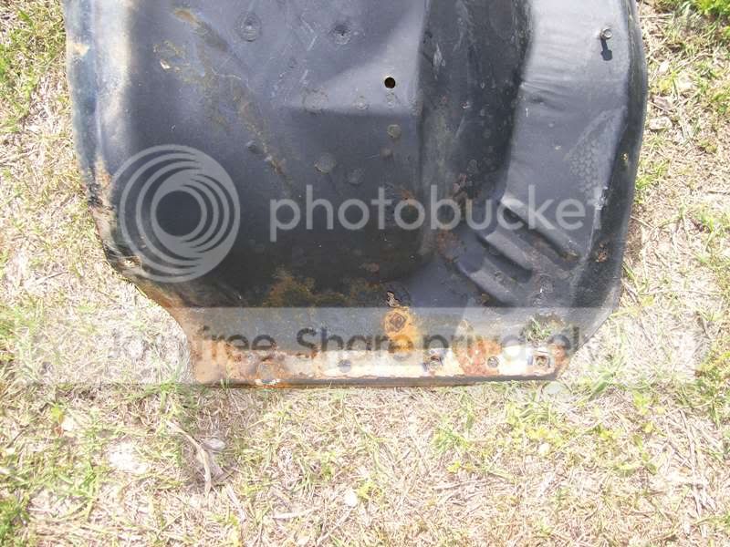

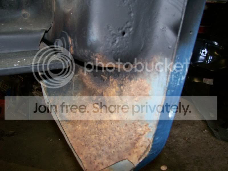

Rusty inner fender that's getting replaced:
That inner fender made this problem (partially sprayed with rust converter):

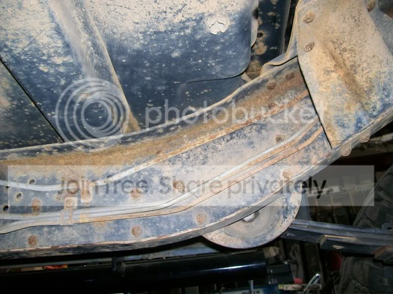

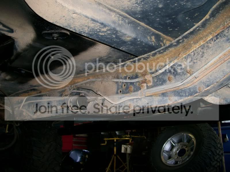

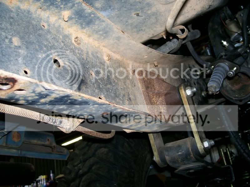

Rusty frame and lines:

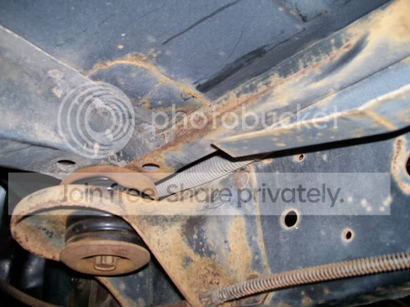

Looking down that framerail:

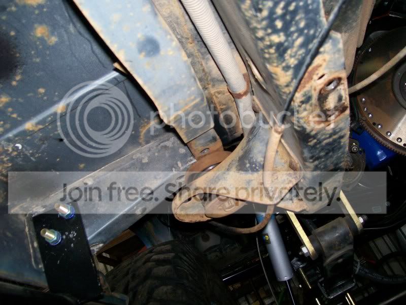

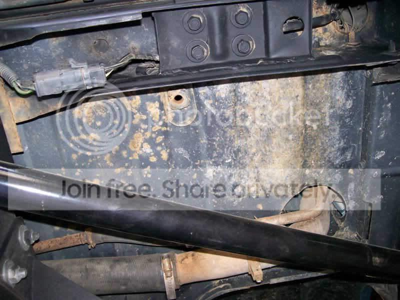

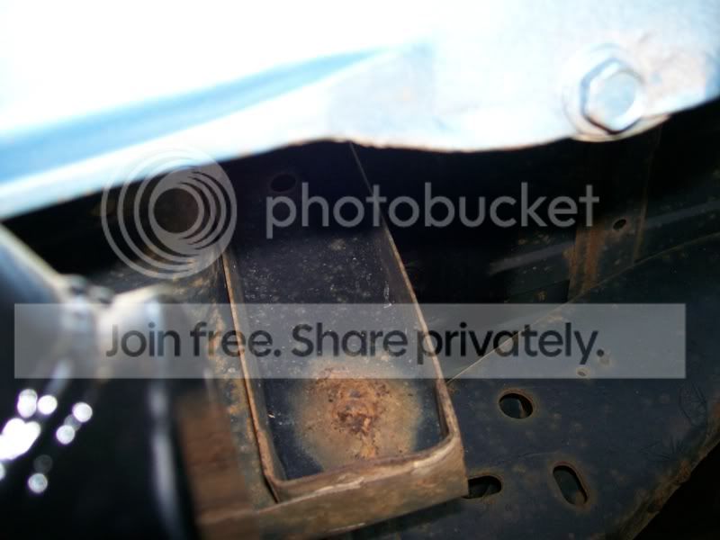

Driver's front floorboard body mount (they all are about this same condition):

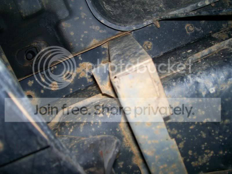

IDK what part of the body this is called ( bump up for the rear floor, 2 shots):
Passenger tail:
Another driver's floorboard body mount shot:
Inside of framerail at same location:

I don't think the rust you have is that bad, it's there and it would get worst untreated, but not that bad. I would wire brush off the worst, and then apply either a rust reformer or rust bullet or POR15. Then I would use some kind of paint as a top coat. It all comes down to just how much time and $$ you want to spend. POR15 and Rust Bullet are expensive, but so is a rusted out truck.
Personally, I would not use a wire brush as the last step. They tend to gloss over the rust and make it look shiny, like it was good steel. You need to get as much rust out as possible and it has formed pits. A flapwheel does a better job of digging it out.
If you want to do a "quick and dirty" job on it, why not just get a small bugsprayer tank and some hydraulic fluid? Set up the sprayer nozzle for a fine mist, and then just crawl around and soak all those areas with the oil to saturate them.... a quick drive down a dusty road will help stick the oil in place and you can occasionally get back under there for touch ups as needed. The nice thing about the oil is that it will seep behind things like the fuel and brake lines where spray bombs won't reach....and ultimately it's just oil, so when you are finally ready to REALLY take it all the way down for the complete restoration, all you need to do is steam clean it to remove the oils.
For what you want to spend (dollars and time) it might be the most reasonable approach. Once you start getting into wire strippers and spray paints, you're awfully close to that "Might As Well..." phrase that suddenly has every nut and bolt removed and the entire truck torn apart! :D
