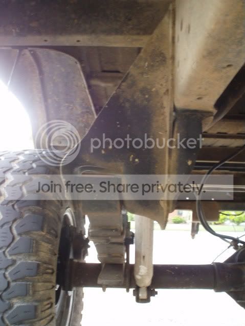

Alright I ordered a 4" rough country lift with new rear springs and I'm going to be installing them tomorrow. The only thing I haven't been able to find anything about is which way the rear springs go on.
side #1 the second leaf wraps about halfway around the eye
side #2 the second leaf stops about an inch before the eye.
Sorry about the crappy pic, the stuff is over at my friends house or I would take a better one but I'm sure you guys know what I'm talking about.
Just need to know which side goes towards the front.

I would say the side that the bottom leaf wraps halfway up would be the front.
There's a tapered shim on the bottom of the rear springs, the thin end go tord's the front of the vehicle.
I think that's how mine are i would go out and look but its raining. The thick end of the shim goes toward the rear.
The only problem is that bottom straight leaf spins freely so I don't know how many times it might have been spun around while being shipped :confused:
Is'nt the thin part of the shim pointed towrds the front the same as the thick end towrds the rear.:D
yeah I called my friend and had him look and he said they are pointed different ways from being moved around so that isnt really any help :(
i remember mine doing that now
the half rapped spring eye goes to the front just checked mine.
Thanks man, That's the way I put them on. Seems like that extra spring would rub on the hangers if they were the other way around.
