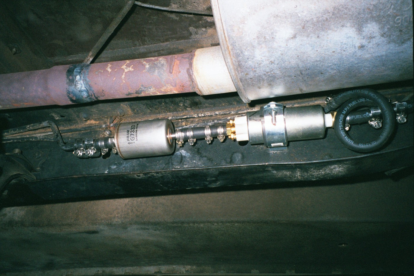

My fuel pump is mounted on the pass. side frame rail.
In the pic you can see on the right side that the frame reail is JUST starting to angle up as it starts to go over the axle area.
I mounted it as close as I could to the tank but keeping it level and below the tank as best I could.

Crap, so I mounted mine in the wrong spot? /forums/images/graemlins/confused.gif Ill see how it goes this tank!
