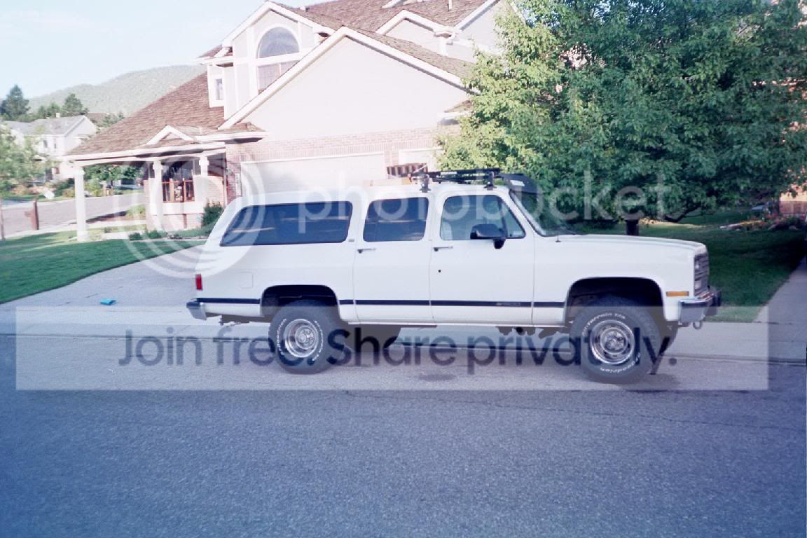

Here is my old suburban with 33x12.5r15's on 15x8 rally's.
Can't see the pic but thanks. The ones on eBay were the thicker rings with the hole through them. I think I might go this route. $121 sure beats the price of wheels!:waytogo:
Here you go.....

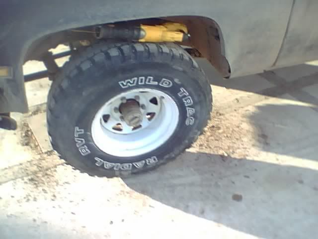

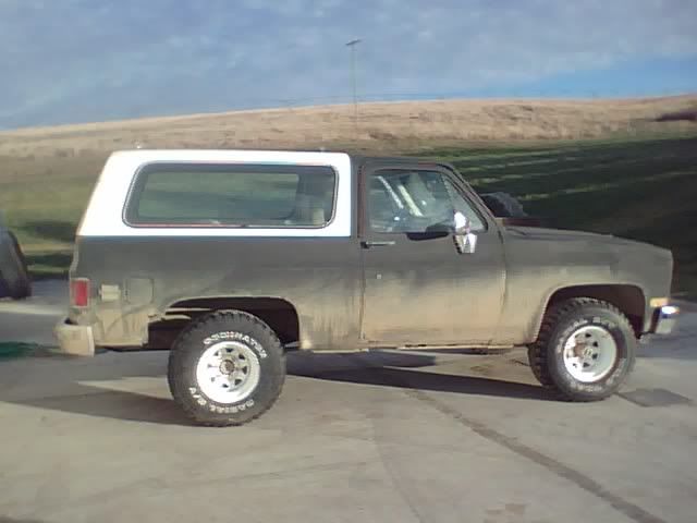

I have a set of 31x10.5x15" BFG All Terrains mounted on a set of 15x10" white spokes. They look a little odd, but it's not bad. I'll see if I can find some pics.

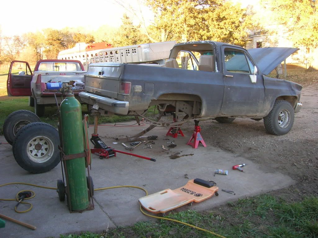

Haha, here is when I first bolted those white spokes on. An old worn out set of 33x12.50x15's I had.
It wouldn't turn.

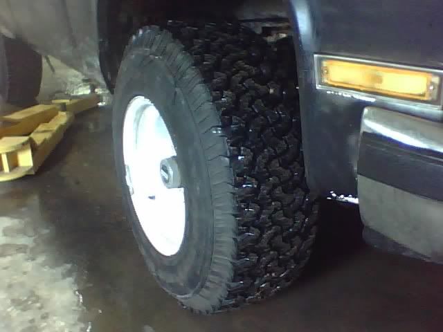

Here is another shot of those wheels with the 31's.
