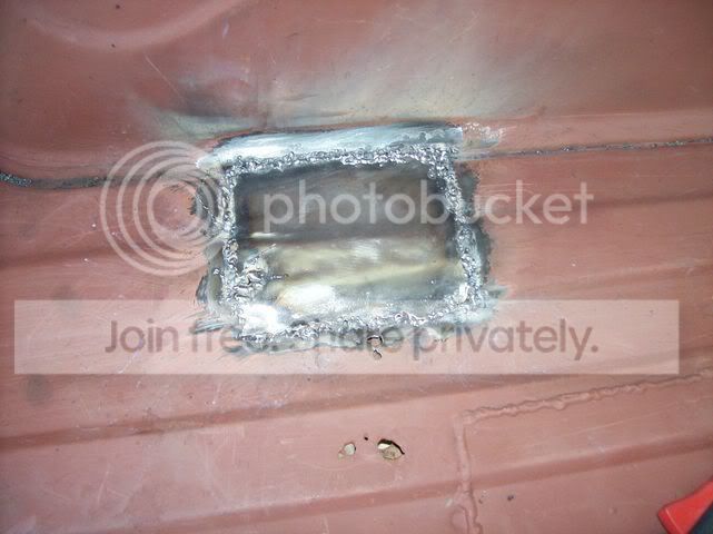

I'm in the middle of trying to weld a piece of sheet metal in my floorboard. I'm a noob welder, so I'm trying my best, but for some reason my little Craftsman MIG welder is eating right through the sheet metal that I bought. It's 22 gauge sheet metal, so I dunno what the problem is. Any suggestions from you master welders?

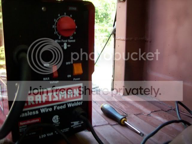

Well it's just a little mig welder with Hi and Lo voltage settings, and a wire feed speed setting. Nothing fancy to adjust the heat with. If I move fast it doesn't eat through it quite as bad, but the bead looks like $hit.

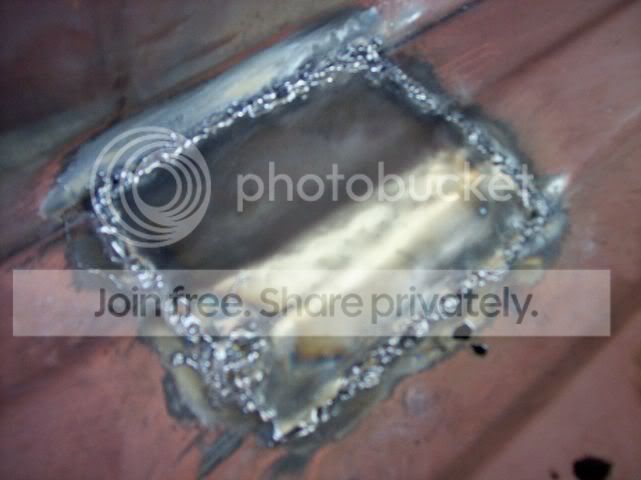

Well the welder is crap. It won't even lay an even bead on anything. It just pops and crackles and leaves a bunch of slag everywhere. I finished this one little patch and it looks crap. I dunno what else to do, I guess I'll have to find a friend with a better welder or use JB weld as mentioned above ;)
Well I had my buddy try using my welder, and he's taken welding classes and I've seen some of his work, and when he used my welder, that's exactly what happened. It looked like crap. I guess since there's no way to adjust my welder, I just have to make due with that?

That's what I considered doing. I plan on doing Herculiner on the whole bed when I'm done. If I ever get done. I want it to look decent, but I'm not super worried about being able to see some stuff. I have it somewhat tacked, but there are a lot of holes where the bead didn't cover well. I'm trying to decide whether I should cut it out and start over, or just seal up the holes with JB weld and have my buddy help me with the rest of the welds.

my grandpa has an old lincoln gasless like that, just a high and low setting. it welds preaty good being what it is.
get some 16 guage and turn it on high and play with the wire speed till it welds good. you will have to stop and let it cool every once in a while so it doesn't burn threw but its better than a cold weld.

I can't see any pics at work but are you running gas? If not do you have flux core wire? The popping makes me think you are not shielding the weld in any way and can lead to a really crappy weld.
Just a thought
