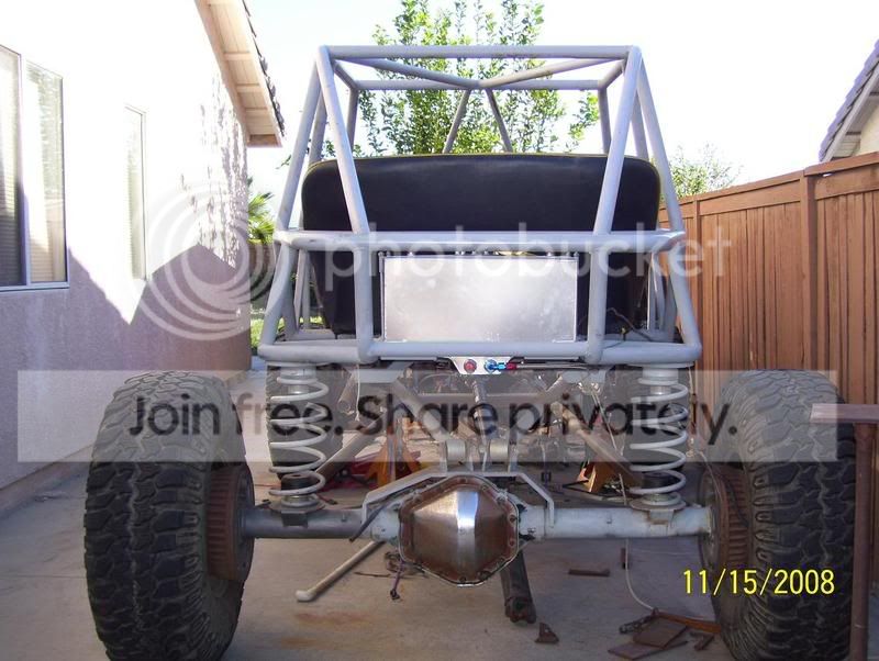

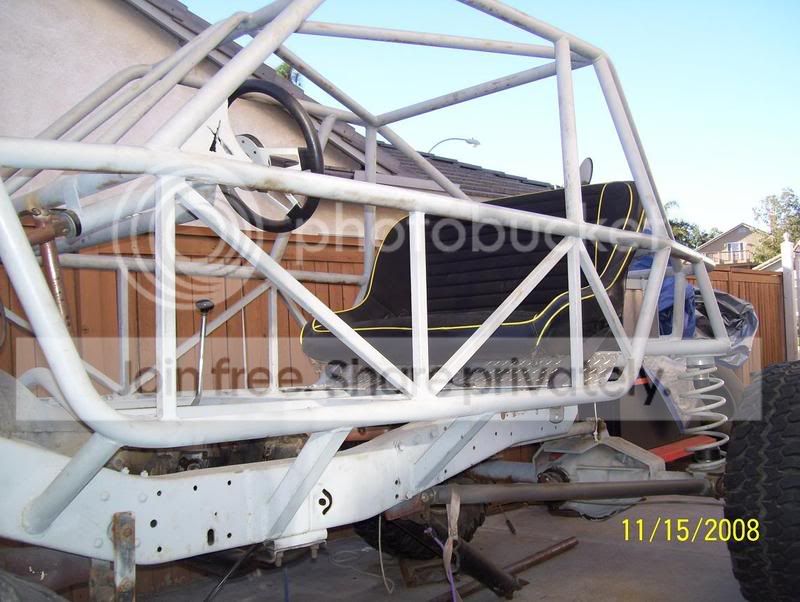

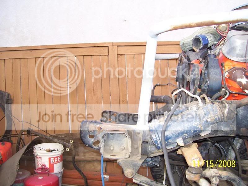

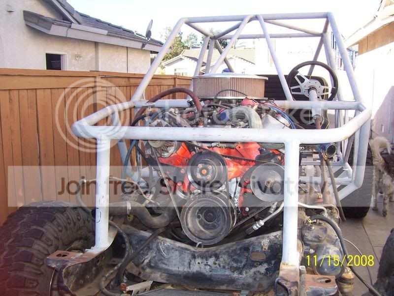

Here are a couple recent pics.
Here is a front side shot, this is the reason I want to mount the rad in the rear, it will stick out like a sore thumb up here because it has to mounted outside the chassis and I have to make some kind of cage to protect it.

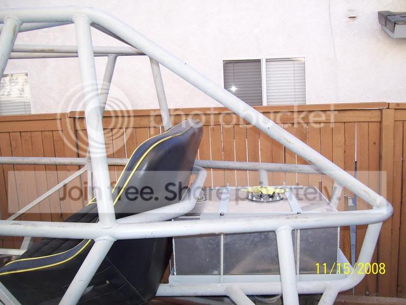

Here is a shot of the rear side, where I would like to integrate a mount into the passengers head area cage I will make.

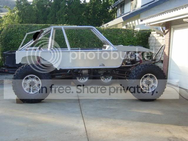

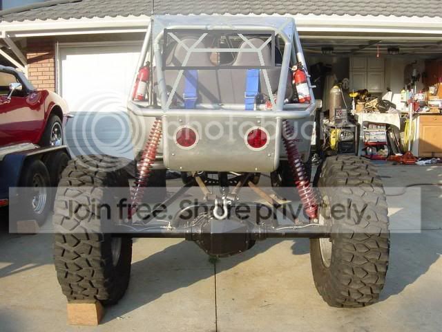

Here are a couple shots of someone else who has the same chassis, I edited the pictures with ms paint to show the structure I would like to build if I mount in the rear.

Radiator in the rear means more metal surface area for heat transfer, moving your radiator to the rear shouldn't hurt cooling performance.
