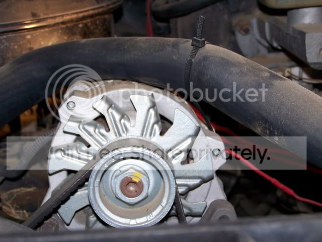

SO I swapped in a 4 row radiator out of a big block 91 R3500. Th only upper radiator hose I can find that remotley fits is from a '90 v3500 w/ a 350 motor.The problem is the hose sits on top of my alternator. I'm afraid when the hose moved when off road, it will hit the alternator fan thingy. Any idea what hose I can use?

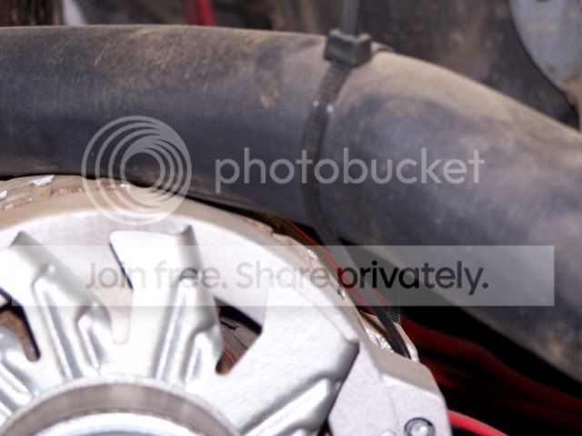

My Blazer uses the same hose as Pauly's NBS truck. Here's a pic of mine:
I think someone put the wrong hose on your truck at some point... either that, or the PO was smart when he swapped a 4-core radiator into my truck, and found a proper-fitting hose:dunno: Anyway, it should do the job for you :wink1:

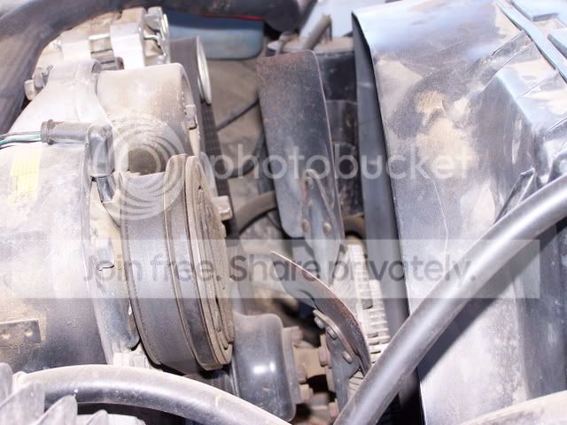

Are those stock small block shrouds? I installed the one from the big block and it has a big gap wher ethe fax is exposed?

The BB shroud will be shorter because the engine is longer.
What he said. Go to your local friendly Chevy parts man and het a stock shroud for your truck. It should fit with some trimming - mine did :D
