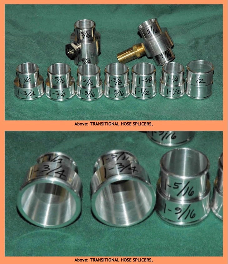

I am using a Griffin direct fit LS 4 core radiator to do 6.0 swap. Both inlet and outlet are on the passenger side.
Upper water pump neck size is 1.325" with the radiator upper being 1.262". Lower water pump 1.58" with the radiator 1.52".
Typical upper hose for the 2005 2500HD 6.0 donor is a hose that crosses over the top of the radiator so that won't work.
What have you guys used for your swaps when using a non factory old school cross flow?
I am going to list what I find as I mess around and research.
Upper Gates 21439
attachment.php
Close one - I didn't have a local auto parts that carried Gates, so I ended up with a Dayco C71588 for the upper and a D70649 for the lower - http://67-72chevytrucks.com/vboard/showthread.php?t=601424&page=3
