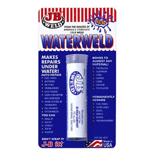

I wouldnt use it. Get a tube of this.
Ive used it many times. Had a gash in my radiator about an inch long and mixed this stuff off and gobbed it on there and good as new. Used it to repair pipe on my sprinkler system etc. Great stuff
