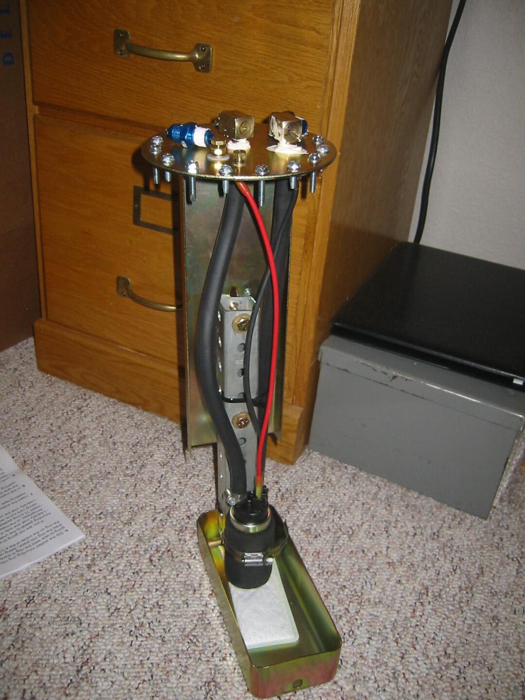

I put a ramjet 350 in my k5, I have an old-school hickey tank from the 70's, 40 gallon.
I installed this into it:
Check out post 78 here for more info
I had talked with several ramjet owners from other places, some in trucks, some in cars, all that tried the inline pump reported fuel starvation issues at some point.
