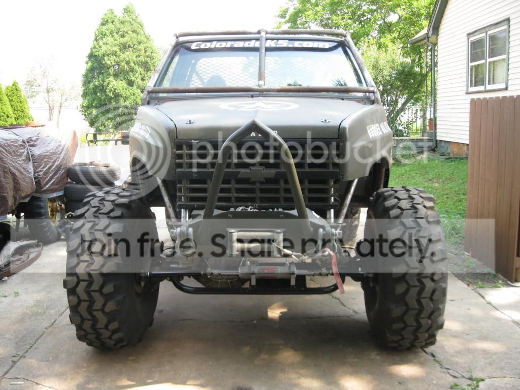

RE-Build Thread: 1989 K5 Trazer "The Dirty Girl"
Some small updates:

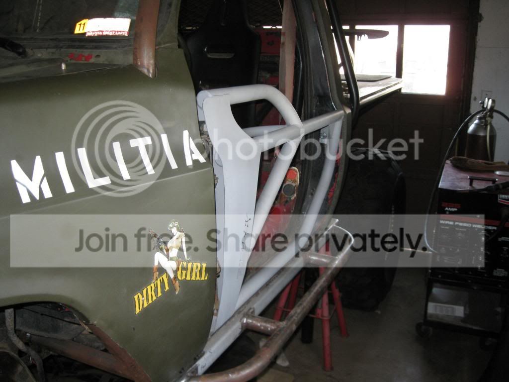

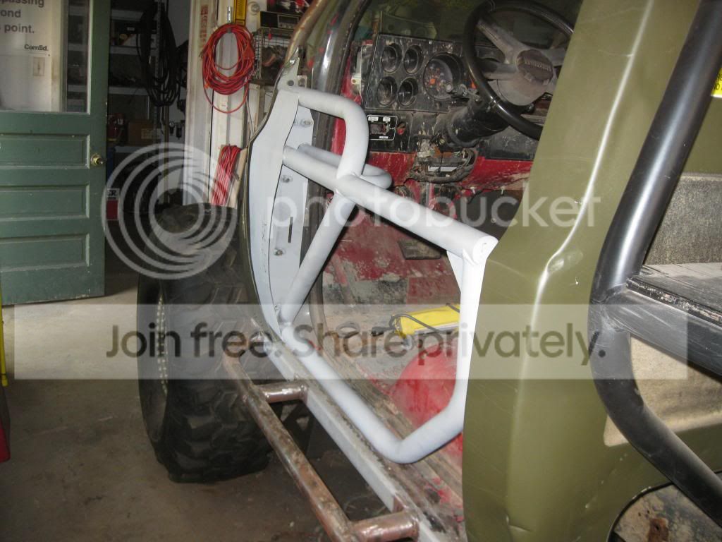

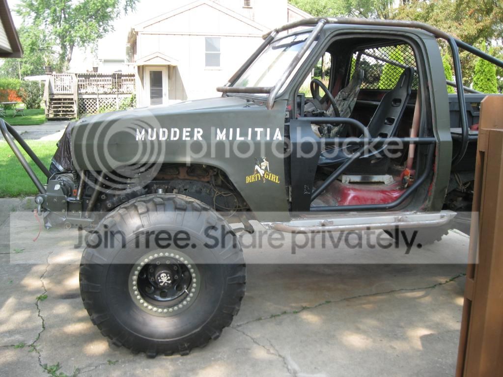

Got the driver side tube door in primer and test fit it. Afterwards, I took it off and painted it. Need to do some finishing touches before I can call the door done.

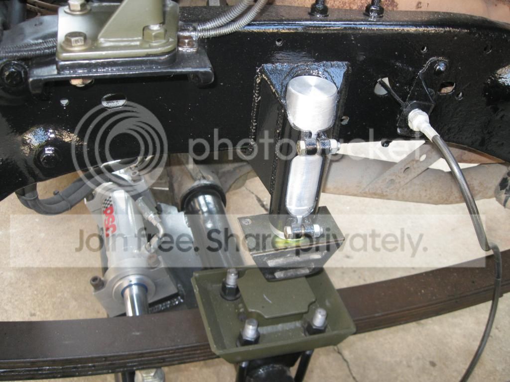

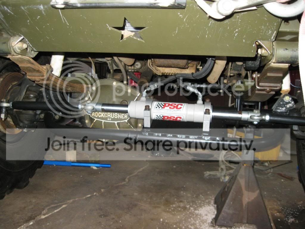

Full hydro steering is done and tested in the garage. Once the system built up pressure and I dead headed the pump when the tires were turned at the steering stops, we quickly realized that one of the hoses used was incorrect. It was a low pressure hose that should have been a high pressure hose. 45 minutes of cleaning up power steering fluid that sprayed everywhere and then a hose swap, everything was then ok. Whoops!

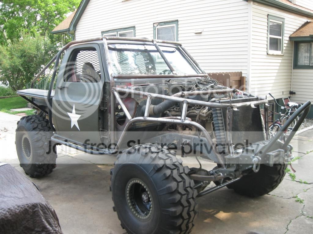

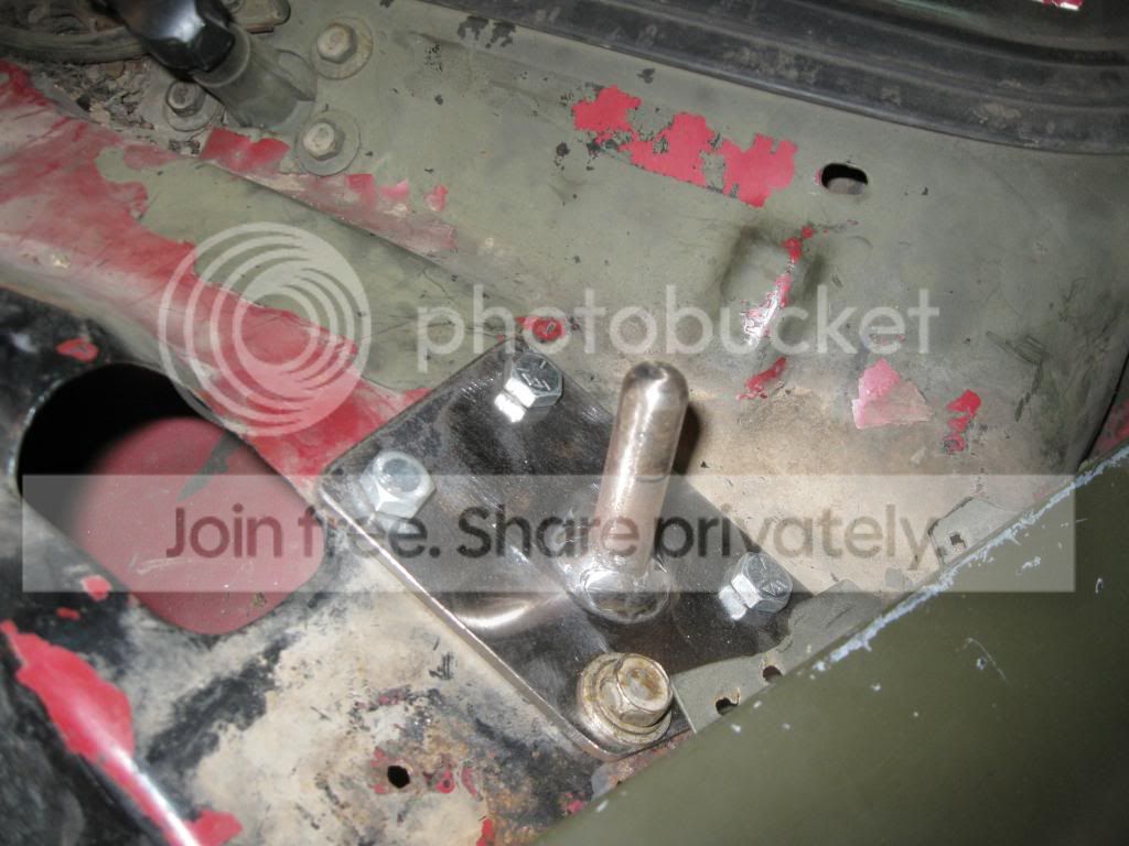

My bro fabbed up the rear mounts for the hood

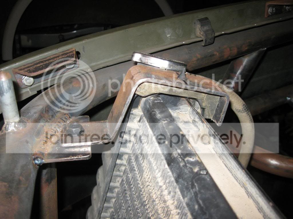

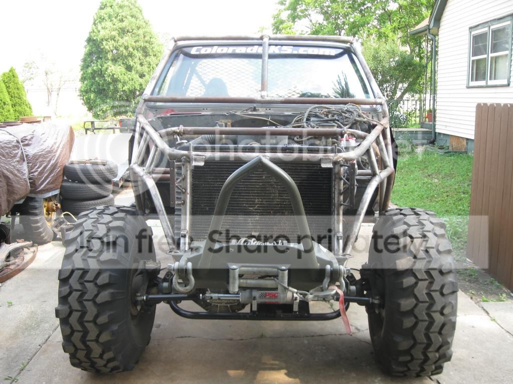

And then moved on to the radiator:

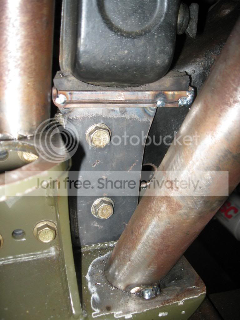

The lower mount utilizes two bolt holes that were already in the B-52 bracket. A little more welding, primer and paint, and the radiator mounts will be finished.

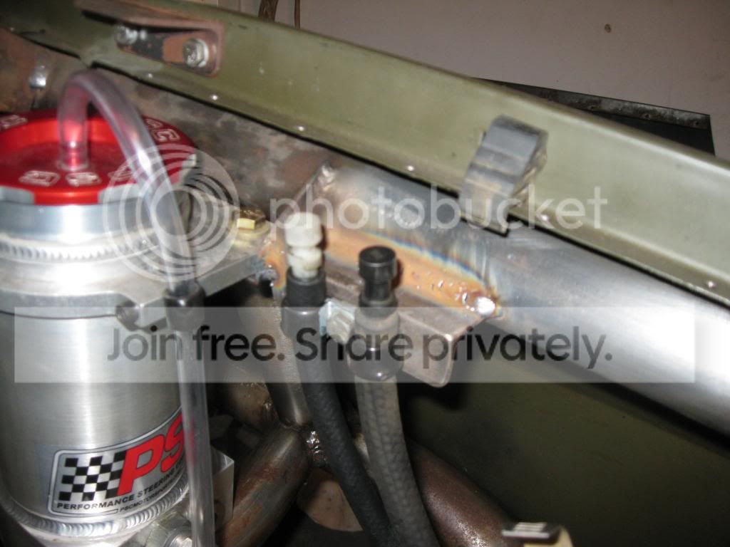

Also found a place to mount some breathers:

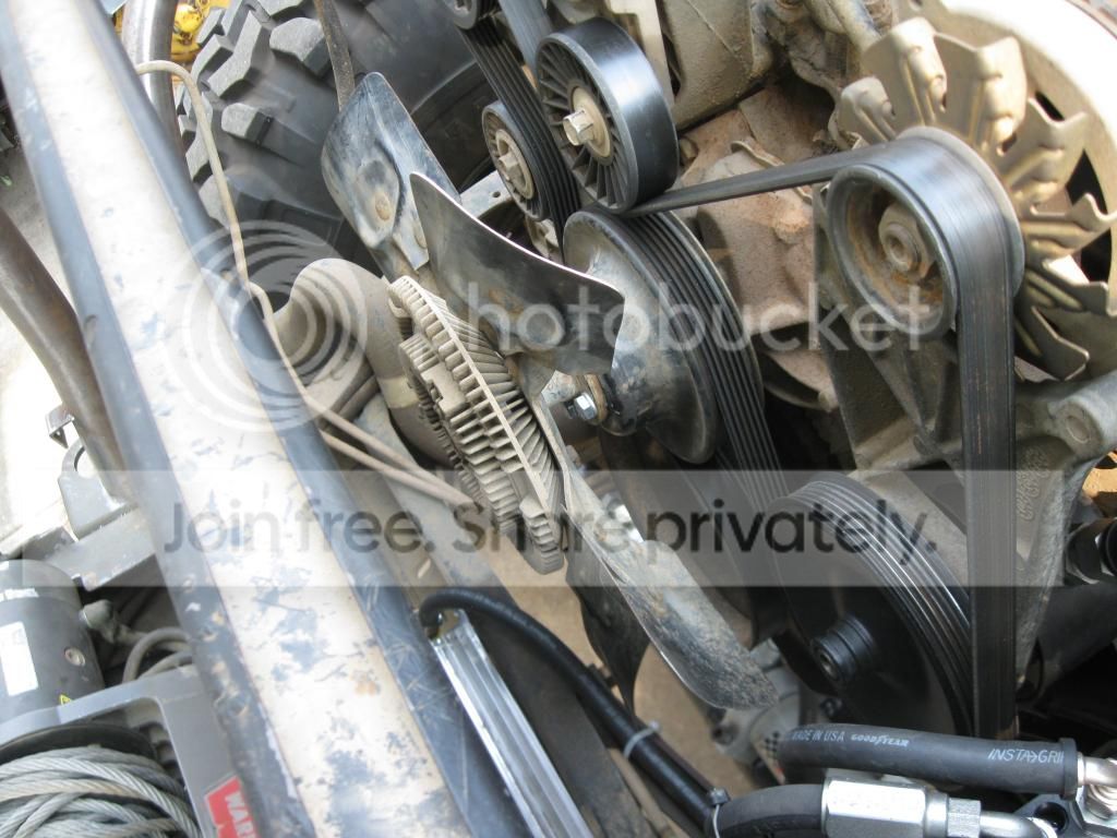

Next up, I need to order up some scuff plates for the hood pin setup, a swivel water neck and accordion radiator hose. I also need to get a smaller flex fan. The stock fan will no longer work, it would have hit the hydro steering hoses. I do have a windstar dual electric fan setup, but at this point, we just want to get the truck out of the garage and into the mud. So that will have to wait for another day.

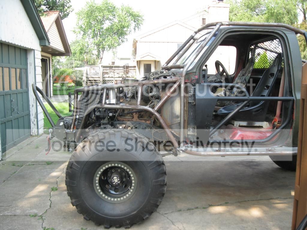

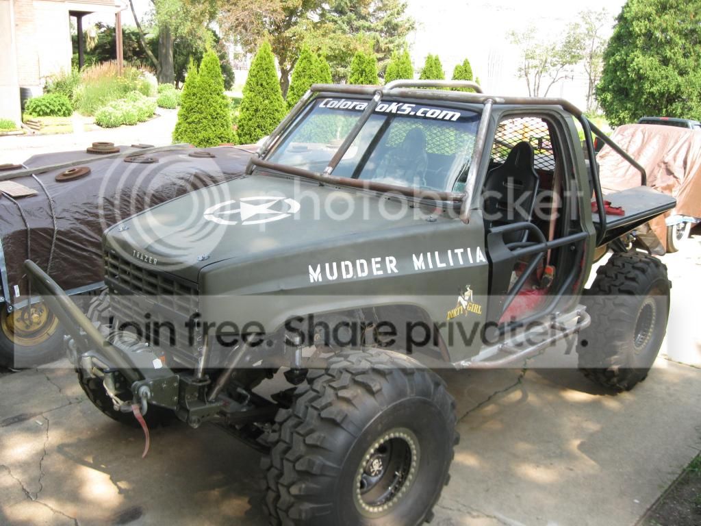

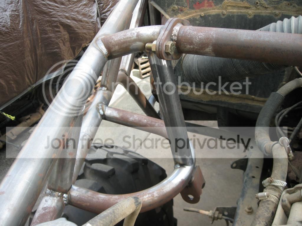

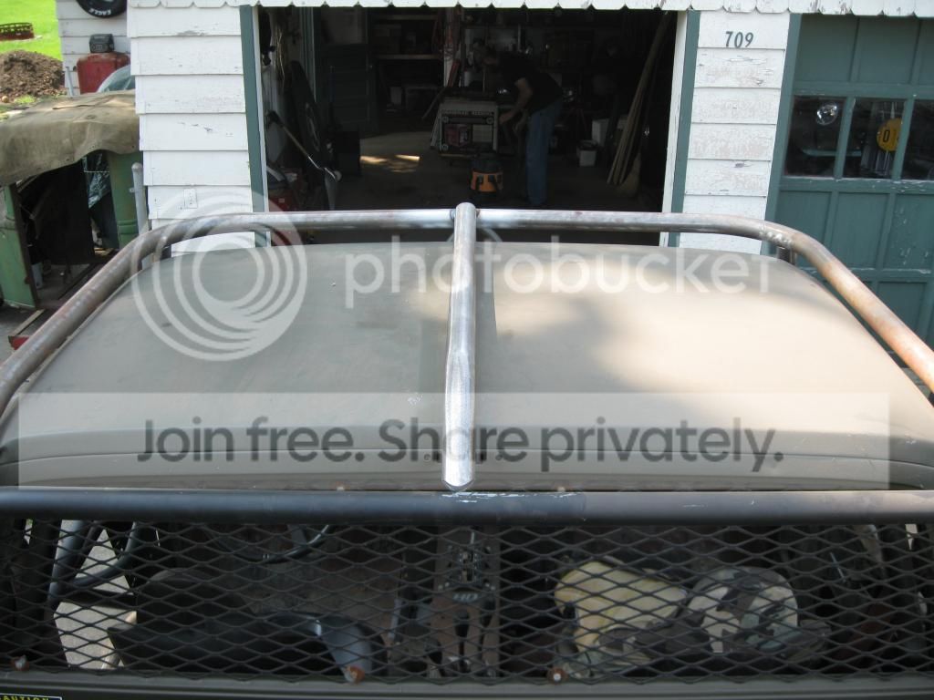

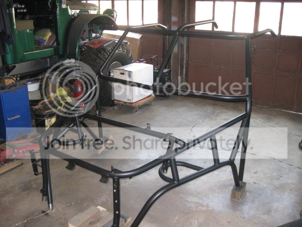

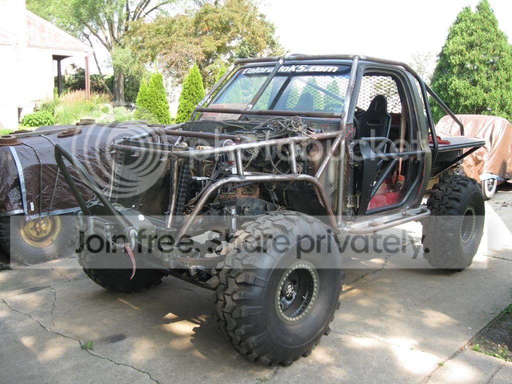

Sorry for lack of pics. Wiper cowl bar is done and a brace down the middle of the windshield from the roof halo to the wiper bar is done as well. Today after work we are going to get the mechanical fan cut down for clearance, finish up hood pins, my bro is going to weld a little more of the cage joints and then we will pull off the front sheet metal. Friday my Bro will had a tube support on the roof, then Saturday we will pull the truck out of the garage, remove the front cage work so my bro can weld up the hard to reach areas. Sand/scuff down the tube work. Then prime and paint it. We can then put the tube work back on to the truck and weld it back to the frame. Only thing after that is to finish painting the passenger side tube door, replace the battery and do a final check before the rig is ready for the Silver Lake dunes!

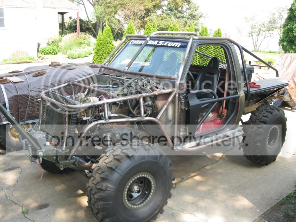

And here's some pics of what happened the last few days. We took the truck outside. Removed the cage, painted some of the frame, my bro welded the hard to reach are of the cage. Then it was primed and painted and reinstalled on the truck. Oh and last night the truck decided it was time for a trans line to start leaking. So now that has to be fixed :doah:
Fan was cut down so that it clears the steering hoses.
