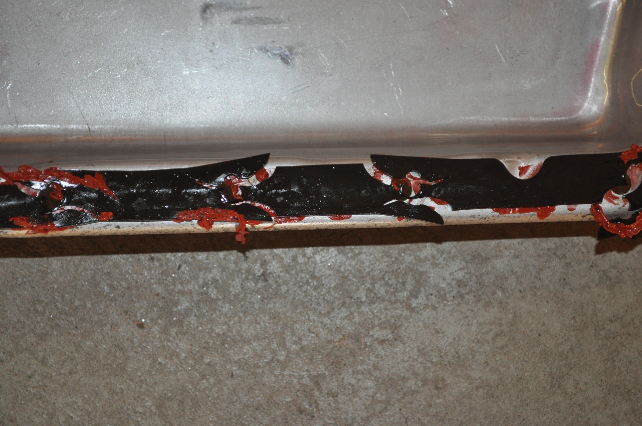

This is what happens when you over tighten the pan bolts. Lube Locker Gaskets work great.....more than once.
