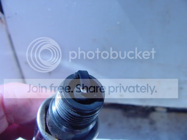

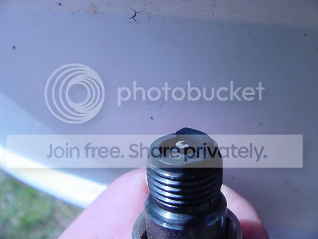

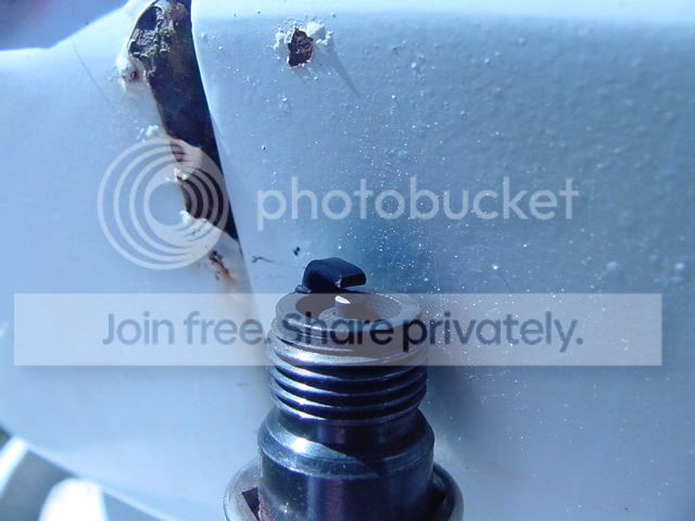

I just threw 2 gallons of premium in the truck and sat there with the key turning over for a LONG time.. giving the starter a few rests of course. The clear fuel filter was full of fuel for quite some time. It won't even try to fire at all right now. So I decided to pull a random plug, half expecting it to be fouled with rich fuel deposits. Well, the plug is bone dry, not really wet with gas, dunno why... but here's another odd thing. It looks like it has been fouled at somepoint with black carbon deposits (man I've gotten used to cleaning those with a wire brush). But it also has a white spot on the electrode, as if its run lean.. its really throwing me for a loop.
Anyone got any ideas?
Looks pretty rich to me, I always look at the porcelain to judge lean/rich (pretty dark in your case). It could be rich due to the choke, I would not say that plug is fouled. Carbed motors are easy: If you have fuel and spark it will start. Check spark at each plug and then make sure the carb squirts fuel from the accelerator pump when you move the throttle.
well, I did run it a while with the choke on warming it up after I put the carb on. I've had plugs be solid black, but the little white spot is really throwing me for a loop. Would a vaccume leak make it run super lean like that? Maybe before I had found the vaccume leak (from not tightening down the screws on the carb enough after I rebuilt it) it caused it to run lean enough to burn off some carbon and make it a little white? I don't understand why I can't get it to fire now... maybe the carb is actually tuned wicked lean, but I could have had a sunk float before the rebuild causing it to dump tons of fuel into the motor? I just can't figure it out.. I've only got one day to borrow this vaccume guage, so I would really like to make her crank up so I can get those idle mix screws tuned perfectly. :crazy:
The only time I could imagine the tip of the electrode being black is if the plug is fouled and not firing. The porcelain tells you how the mixture is burning (somewhat rich in your pics, due to the choke probably). If you cannot get the engine to fire you are not getting either spark or fuel: period. If it starts and doesn't run well then you can worry about whether it is lean or rich.

I've gone through two or three sets, and they all end up turning very, very black.. the white on the tip of that electrode is what was throwing me. Is it concievable to run rich if you have a vaccume leak?

I think that the plug looks like the fuel mixture is OK to me...not perfect, but good enough not to cause a major problem. The plug looks more to me like it is not burning all the fuel completly during the combustion stroke, which can be caused by either incorrect valve train or ignition timing issues.
