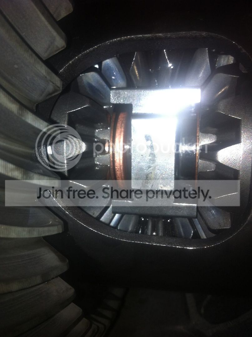

Trying to remove the axleshafts to inspect and hopefully only have to replace the wheel bearing and seal on my 2wd Burb. It has a Gov-Loc.

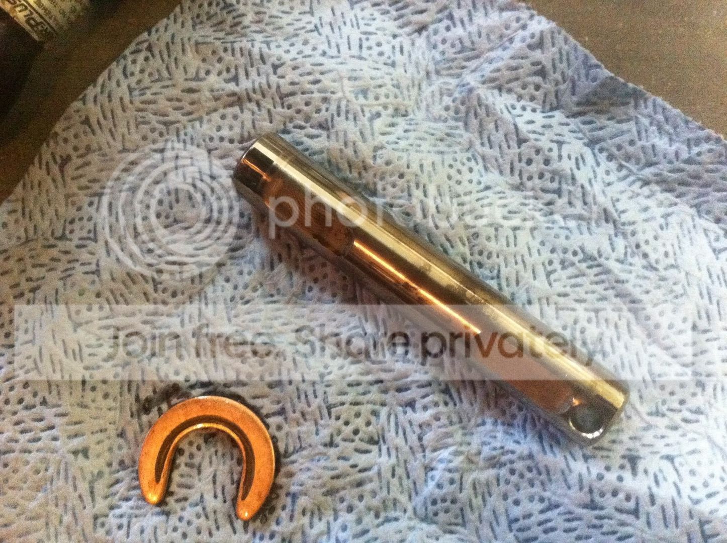

I have the cross pin removed, unfortunately so are the spiders, which I'm having issues getting them back in place as well.
I CANNOT get the axleshafts pushed in far enough to get that C-clip popped out. Does that t-block thing in the center also have to come out.

Ive never tried with a gov bomb in but you really cant push the axle in any more to get the c clip out? whats it hitting? Ive done it with both rear tires off the ground and you pushed one axle in, removed clip, pulled axle.

Shafts seem to be hitting that block in between the side gears. Just can't get the shafts pushed in far enough to get at those clips. I can move them, rotate them around, but not enough to pop them out, can't get that block out.

if so you might have to push in pretty hard, I know I damn near had to hammer my axle in, it felt like something was wrong.
thats as far as my axle went in after i put the g80 in my diff. to get the clips loose i just grabbed the hub and pushed in and out and turned it. as theres no fluid left so i'm not gonna lose it.

I got it all out, I ended up having someone jam in the driver side axle, and that ones clip just about fell out itself, once I got that one out, it gave that center block piece more room to move a bit more to the side and the passenger side one did the same thing.
It's all FUBAR though. I was hoping I was only going to have to replace the bearing & seal... no joy.
