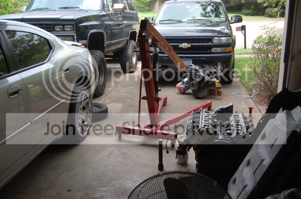

its parked for the day and im going to get some new hose for it tomorrow. have to go by the parts store to pick up a few things to finish the engine swap in my charger
thanks for the tips tho, guys.
cant wait to get the truck runnin like a top now that ive almost finished the charger.
