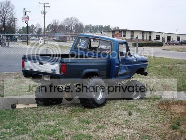

as far as the links go..my buddy is prolly gonna make thoose but im not sure yet...here is a pic of the back of the truck...only things changing is a spare,and a 14 bolt
Are you planning on running it empty, or with a full load of gear? Are you going to keep the flatbed?
just a 40 inch spare,cooler,tool box full of tools and straps....i might later do some sort of a roll bar/exo for the rear but thats a while off right now...im more looking at what its gonna take to get my 1 tons in and going
