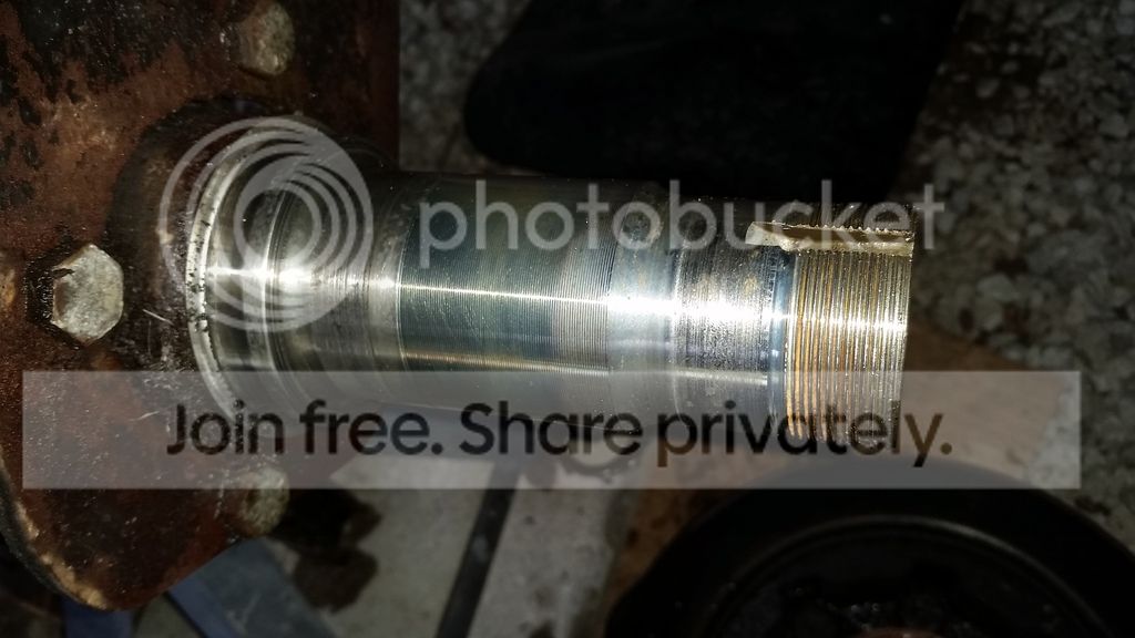

Its leaking again, are the bearings shot?

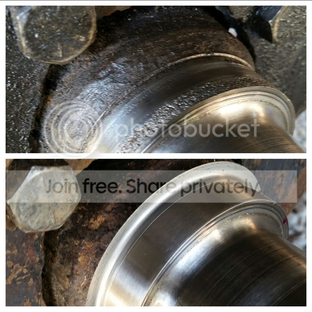

hhmmm I checked on the pirate 4x4 thread and they didnt remove the lip. when I looked through at the leak the seal and the lip werent making contact, I could see light between the two. the seal itself looks untouched. On one set of speedi sleeve instructions online it states "if clearance is needed trim the lip." and another from speedisleeve "Note: In certain applications, the flange will need to be removed. Please check instructions that are included with each SPEEDI-SLEEVE or SPEEDI-SLEEVE Gold to avoid damage." either way Ill have to try that newer style seal maybe it will make the difference.
what do you think about the bearing marks on the spindle itself? Are they an indicator of anything? I was thinking if there was sag in the bearing it might cause the seal to be pushed down and leak. Thinking aloud here. Thanks for your help.

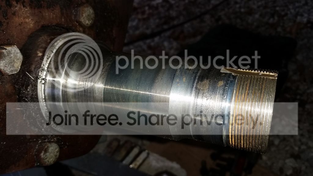

This is what it looked like before the sleeve. Are you positive ill want to take it off?

I checked everything again once I got the bearings set and there is plenty of clearance between the lip of the sleeve and the wheel seal, probably enough to stick a nickel between the two.
