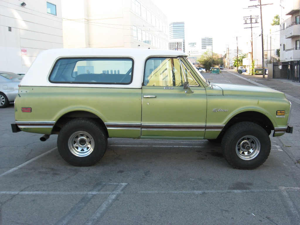

Is it normal for the rear axle to be this far forward? Everything on this Blazer looks pretty stock and i don't see any damage so I figured its right.
Looks about right to how the factory had them set. I looked at a pic I have from a brochure also for comparison.
Yep, that's stock. About 1.5" offset from the wheel tub centerline to the axle centerline....
It gets even more noticeable with lift springs and larger tires. Products like the zero-rate are perfect for getting it lines up correctly....
:usaflag:
I think they made it that way so when the spring flattens out it ends up in the center.
Also note that it's an optical illusion, it's not that far off center, the trailing edge of the opening in the back swoops while the front edge coninues in an arc.
I'm thinking about some offset zerorates for now. Thanks guys.
So I'm about to call up ORD to order some zero rates and u-bolts, etc so that i can shift the axle back 1".
My question is, will I have to extend my driveshaft now that I'm moving the axle back an inch and down an inch?
If that is the case, perhaps I should just splurge on the 4" lift now and then get my rear drive shaft lengthened.
