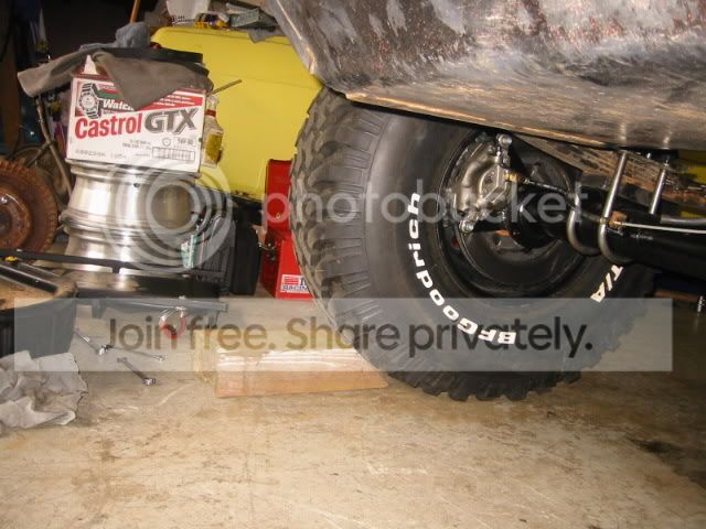

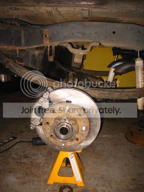

Well some might think that. I finished my rear 60 swap and only need to figure out the brake system and install the detroit and axle shafts. I have air trapped somewhere in the system which kept me from having fun with it this past holiday weekend. Figured I would share the photos of my 3/4 ton (same clearance as my 12 bolt ;) ) axle swap. :cool1:

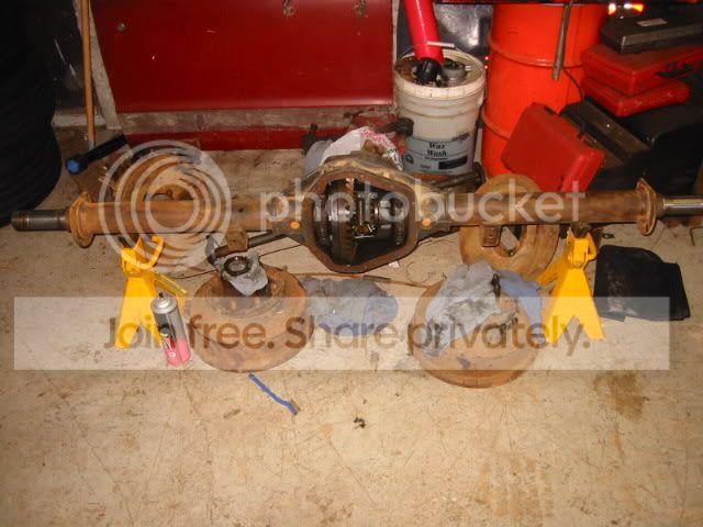

Out with the old 12 bolt, and c-clips. Thanks for the 10+ years of flawless service my friend.

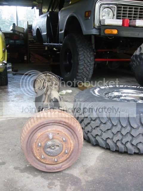

And in with the Furd 60.
In and ready for some bigger meats and the Bead locks that have been sitting waiting.
Looks good! I went through the same issues when I swapped on my rear discs. It took forever for the trapped air to work it's way up to the MC. If you can, take it down and have it power bled. That should cure it.

what spline axles are those
Currently 16 spline, the detroit I have is a 30 spline. Not more beef just more splines, only reason for the swap is lockers are avail. for the 30 spline and not the 16. I would have kept the 16 spline axles if I hadn't got a good deal on the locker. :D
