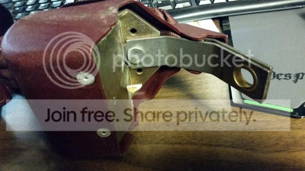

this is the inside of the retractable part. to me it would see you take the plastic piece off and put two bolts through those large circles and mount it wherever, right?

after looking at your picture and comparing it to the part i have there is not way this is intended to work with a blazer. I think the blazer used a much smaller retractable part that was one bolt mounted. I think im going to pursue a refund.
