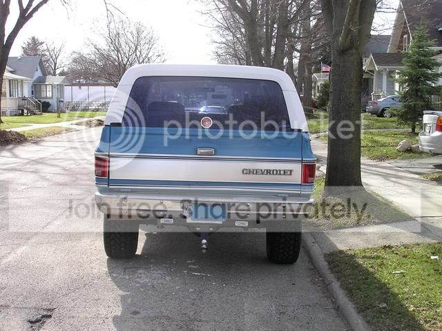

here is a picture of the rear, you can see the type of hitch i got. And you can also see why i wanna build a new bumper.

78...looks like to me all u need to do is unbolt the carrige bolts...have u looked under there yet 2 c where/what the hitch is mounted 2??? doesnt look to me that the hitch bolts to the bumper...at least from the pic that is...looks like an aftermarket hitch...if so, should b bolted to the frame like mine is...
x2 - The two upper carriage bolts closest to the license plate can be a PITA to get to with the hitch in place. Your hitch doesn't need to be removed.

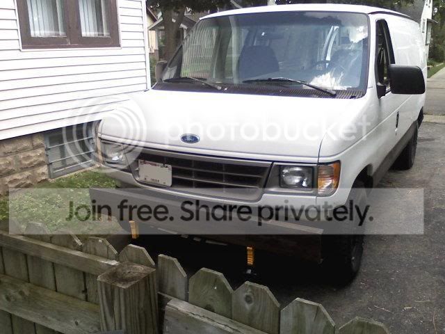

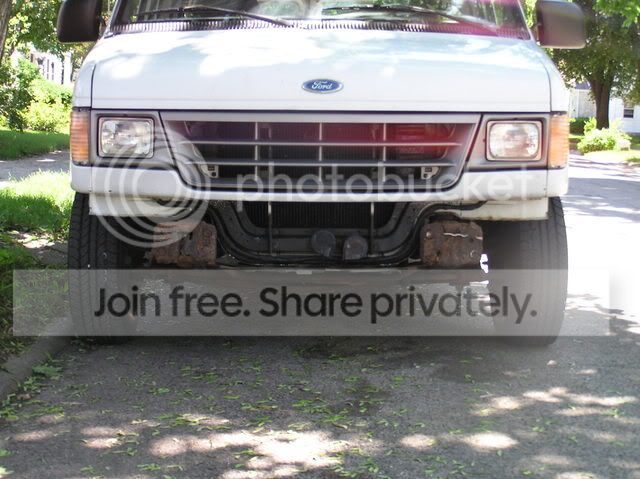

reason i was asking is cause the bumper on my work/daily driver van fell off and i cant get a stock one so i got some C-chanel and i need to bed it a little bit to make it look better.
Ya i know its a ford, but i got it for $400 it runs and drives, plus it gets 21mpg.
