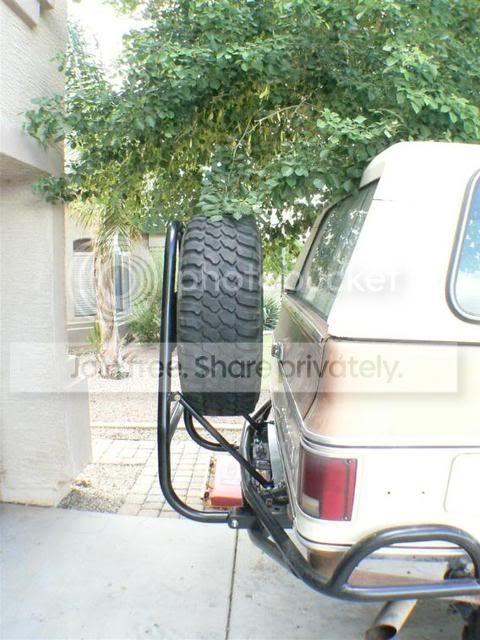

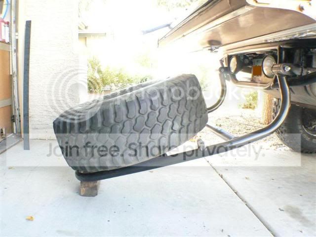

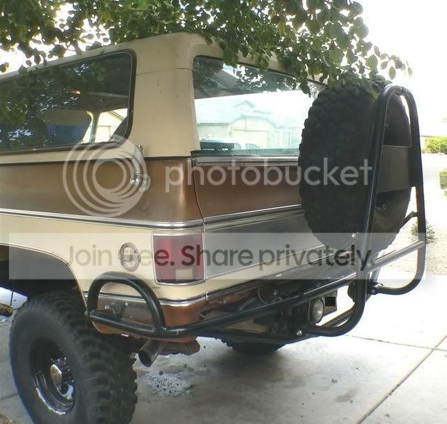

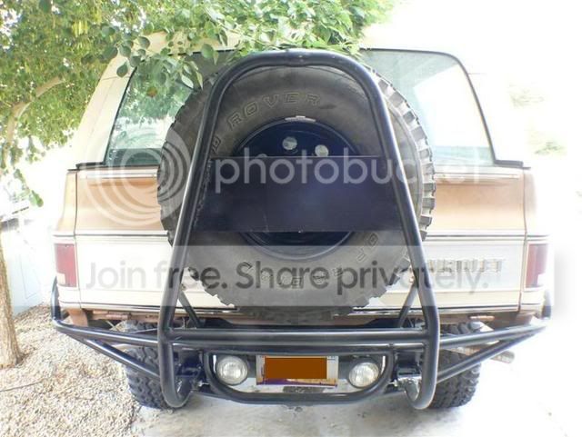

Here is my rear bumper. I am thinking of selling it and fabbing up something different, lighter, etc. Move the spare back to inside.
Anyways, its very durable and works well.
Something to keep in mind. I bought my bumper pre fabbed so I was limited on its mounting, But a small section of the frame had to be cut and I lost the tailgate tension bars, Ive gotten use to it, but it is something to keep in mind when you go to fab up your bumpers.

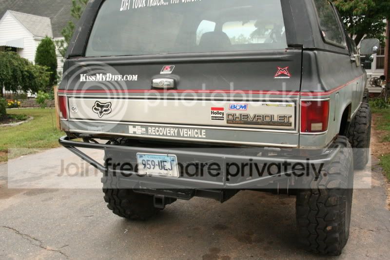

old paint job but same rear bumper, if u look close i have tubing going under the bottom of my quarter panels to help the sides,o ya, and i put some rectangle reverse lights on either side of my plate

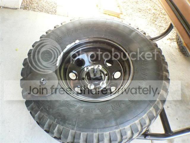

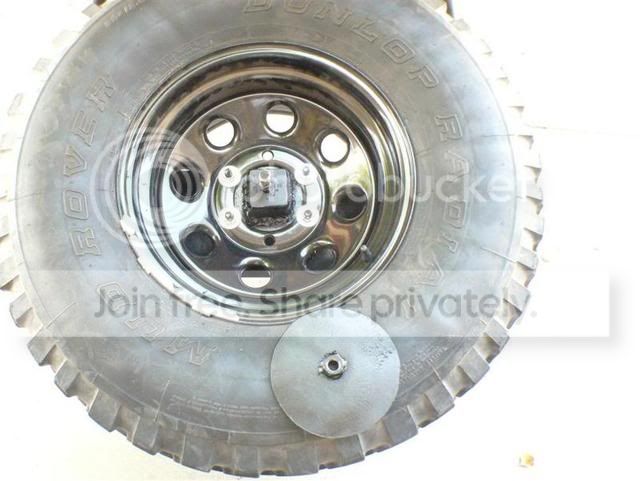

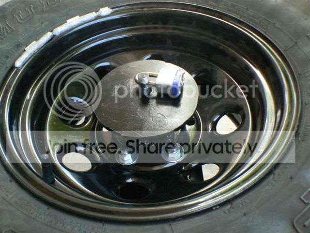

has a tire carrier but not any good pics of it
Jamber, is that a lock-in/out hub on the tire carrier ???? If so, does it work ok ?
came from a Dana 44, I works great I can actually lock it when its open so opening when the truck is an angle or its really windy is no problem.
Badass cage dude. Will the hardtop fit over it??
Jamber that's a cool idea. thanks.
