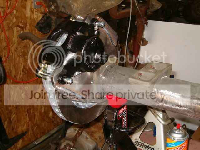

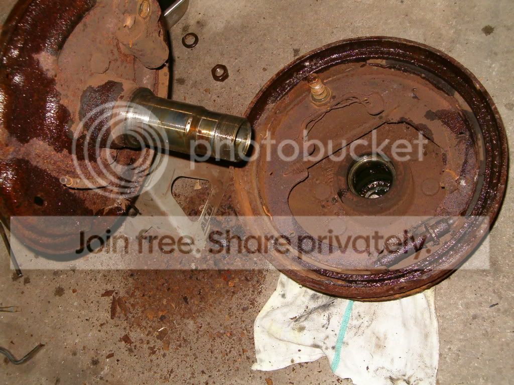

Thats what sold me on it. My drums were shot, and all the hardware was rusty, and the shoes were broken.
From this:
To this:
