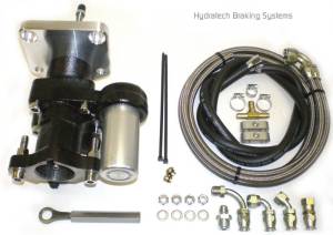

my pal at motor city K5 offers this here hydro boost option. taps into the hydraulic steer pump. he highly recommends, and knows what he's talking about.
anyone have experience with the install?
should i upgrade my hydraulic steer pump to what?!
I ended up going hydro-boost on my '70 K10 after doing the rear disc swap. Part of my reason was because I need to tuck it back a little compared to the factory booster. I needed the space for my A/C compressor lines.
Mine has worked fine with the Corvette master cylinder, but it has pedal feel that is firmer than I would like from an assisted system. Trying to keep it 100% clean and free of oil residue seems impossible, but I may be missing something small.

strange that hydro boost would have firm pedal feel. apparently vacuum boost is 500 psi, hydro boost is 2000 psi.
does it get oil residue from the hydraulic pump? elaborate on the 100% clean...?
I am guessing that the firm feel is because of the master cylinder bore size. I never tried changing it for another as I have good brakes, just firm which is better than having too much pedal travel.
Mine is always damp looking after heat cycles and a few miles. I am not sure if it is a fitting or the seals on the booster. I never found it for sure.
I was told to be careful about overtorquing the fittings in the booster, so it may be a seep there.

Correct, hydraulic oil. But 2000 psi isn't that much pressure to contain. I may have just scuffed an O-ring on a connection. Mine has adapters to convert to AN fittings.
