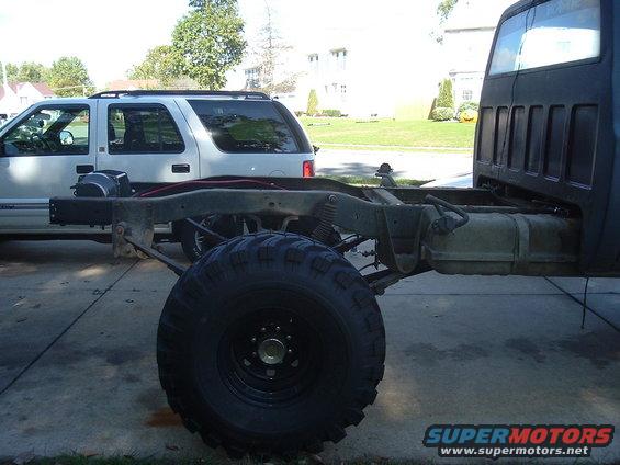

I have a 2 piece driveshaft and want to go 1 piece to get rid of the wobble but dont want to do it as the 2 piece tucks it up tighter...
if I let the clutch out hard enough and hammer it.... the rear wheels will hop... litterally about a foot!!!!!
also what rear axle do you have?
I have a 14bolt ff... look at the side angle they have..
hard to see but look past the patriot 15k winch...
but look at how my dshaft tucks up...
Seems like you would need to go to a cv shaft if you are gonna roll the axle up much.
you need to have your driveshaft set at the right angle so you don;t get any vibes. have a heavier tube driveshaft made.
