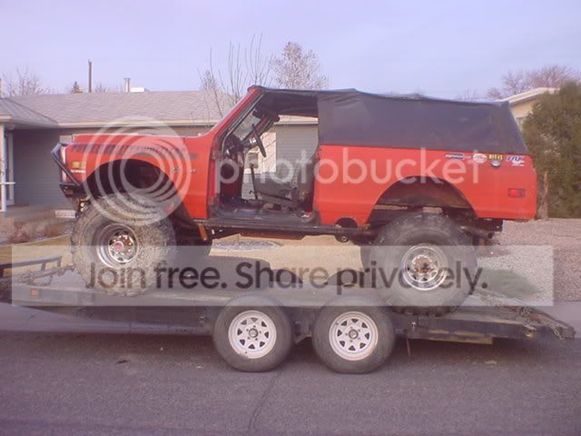

I seriously need to cut the rear fenders on the 71 open ALOT. The tired pretty much rub everywhere and the tired have self clearanced some of the fenders already. I am thinking of takin the inner fenders wells out and cut till everything fits then buils a new inner fender inside to fit. I want to fit a corbeau bench in the rear and the width on theat is 42" so leave at least taht much room. Anyone done something similar and have pics?

Got the outers cut tonight. Friend is building a 71 shortbox and bought all new box parts to make it nice so I got his old inner fenders so I can tub it a few inches too.

It is done.
