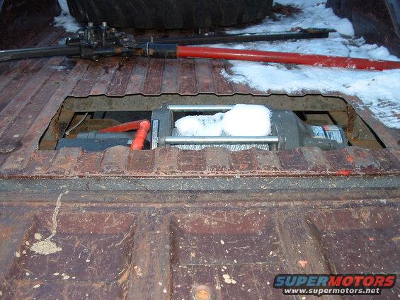

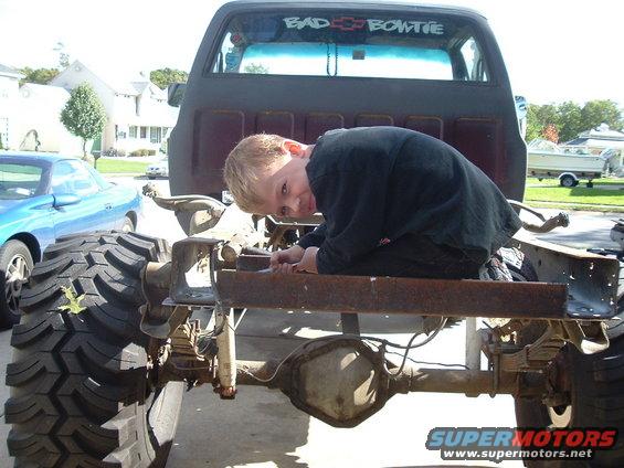

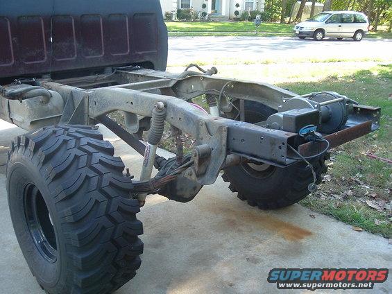

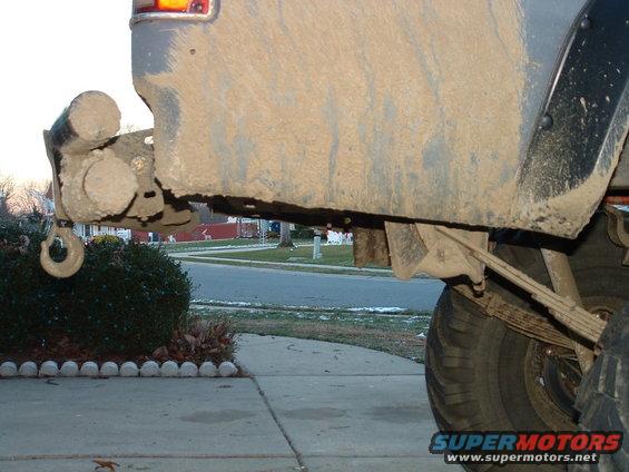

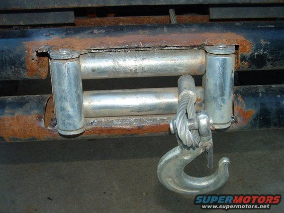

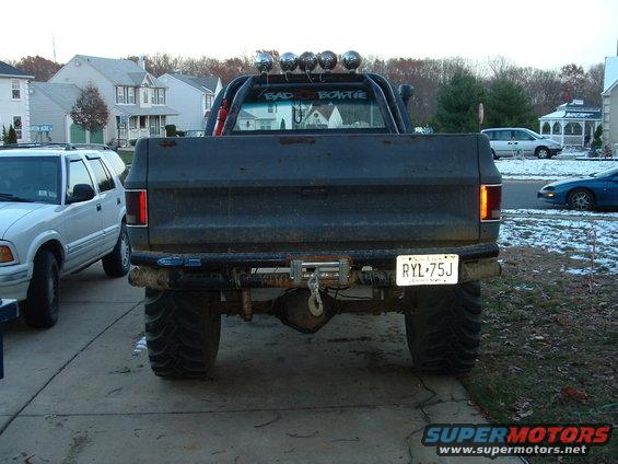

i am one of the few then.... and for good reasons.. will say why in a minute...
got to find my pics...
ok so for me..
I want a big winch in the back to pull me out if i need it (Ramsey Patriot 15,000lb).. I do want to put a hydraulic winch up front.. if I was going forward I want to keep going.. but im a gumbo mud lover so no front winch for rocks...
with that I also want max battery separation from the front so I can kill the 2 batteries trying to get the truck out and still have juice to crank over (on the 2 up front)
I went to a local steel yard... and bought a piece of C Channel... cut the sides off and bolted it up...
i know it is a 78... best i could do :popcorn:
i have a box over the winch now.. to keep it out of the elements.. plus winch is in my garage at the moment... :popcorn:
I suck at welding and was my first attempt.. I want to redo it so dont critisize right now... :whistle:
