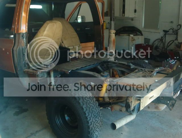

Ok been debating on a set of rear skins "bedsides" for my 75 blazer I know people have done this but I dont currently have the twenty bucks to renew so no search. (michigan unemployment agency sucks)
how bad is it installing them looks to be quite a project....I have a welder, air compressor, torch, grinder basic hand tools what else would I need probally some sort of an air chisel?
basically is this something I can do with some help from the brotherhood thanks ahead of time hopefully I can get a few bucks together to renew later this week.
