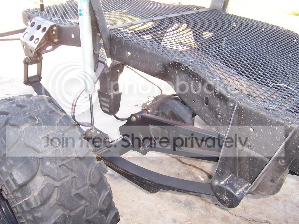

I agree with KTM. My truck is far from the whoop soaking machine his is but I run my shocks over my spring plates going vertical along with an anti-wrap bar which eliminated all of my wheel hop.

Bypasses would be sweet but that's $$$. Until I link this truck this setup was relatively cheap and seems to work pretty well.

do you have more pics or build thread of the anti-wrap bar ?
