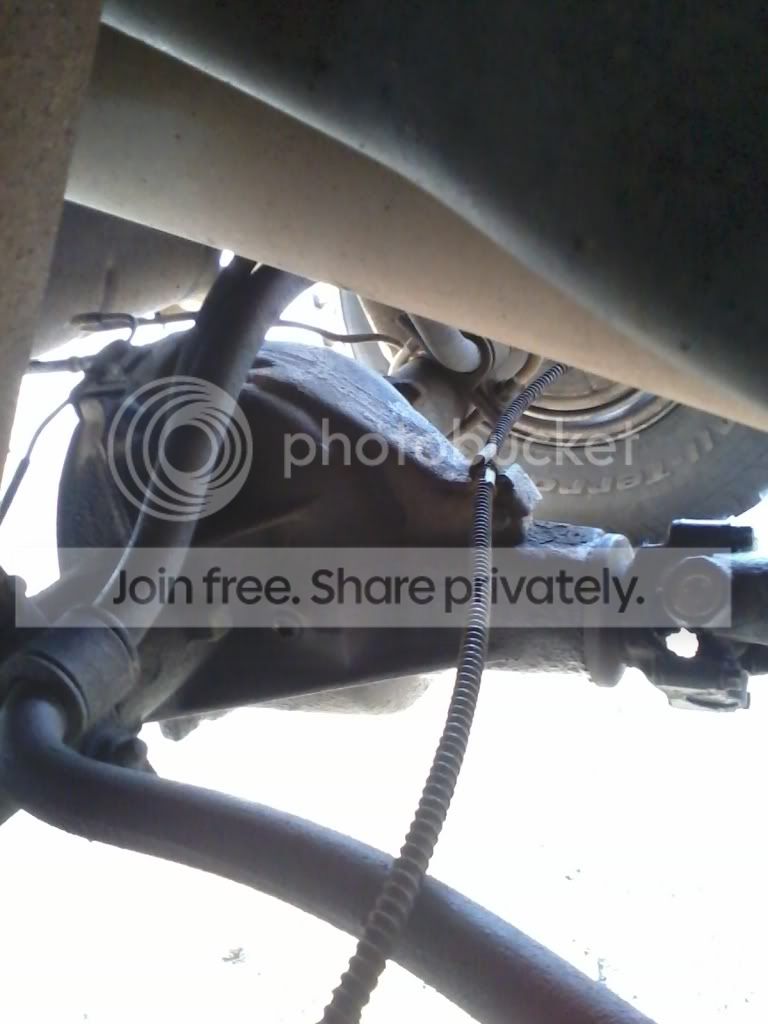

Here is picture of the rear setup. Couple of brackets, bushings and end links that tie into the frame. Simple but it works.
Would've got some better ones but wasn't really in the mood for crawling under it.

Irish thanks for the pic! That's actually perfect I can tell it probably won't work as I have the DIY4X backbone kit on there.
