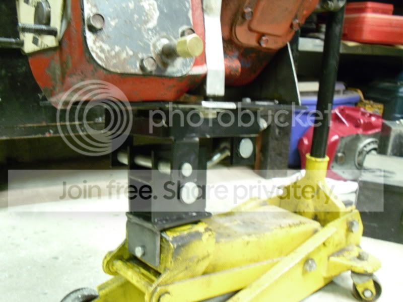

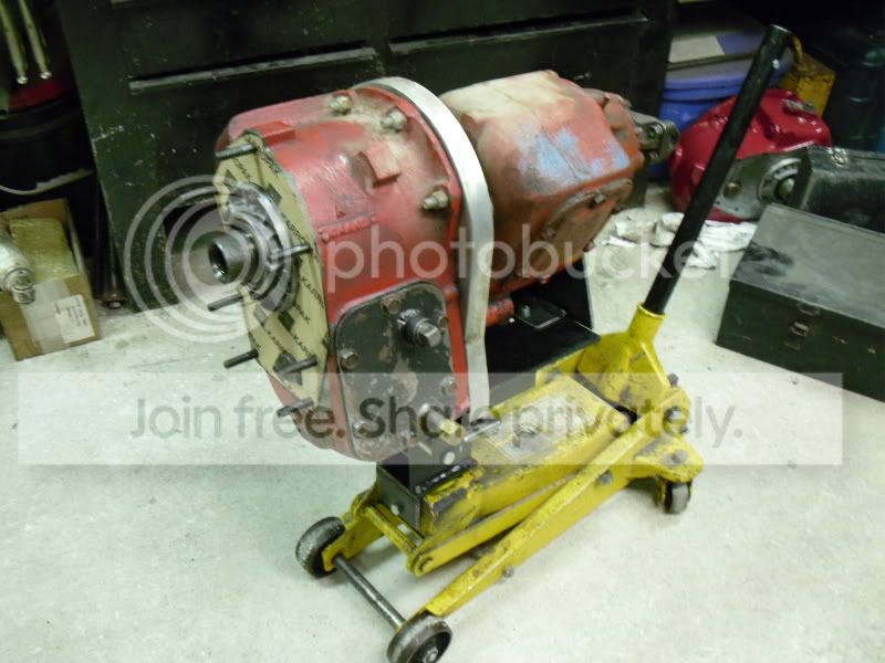

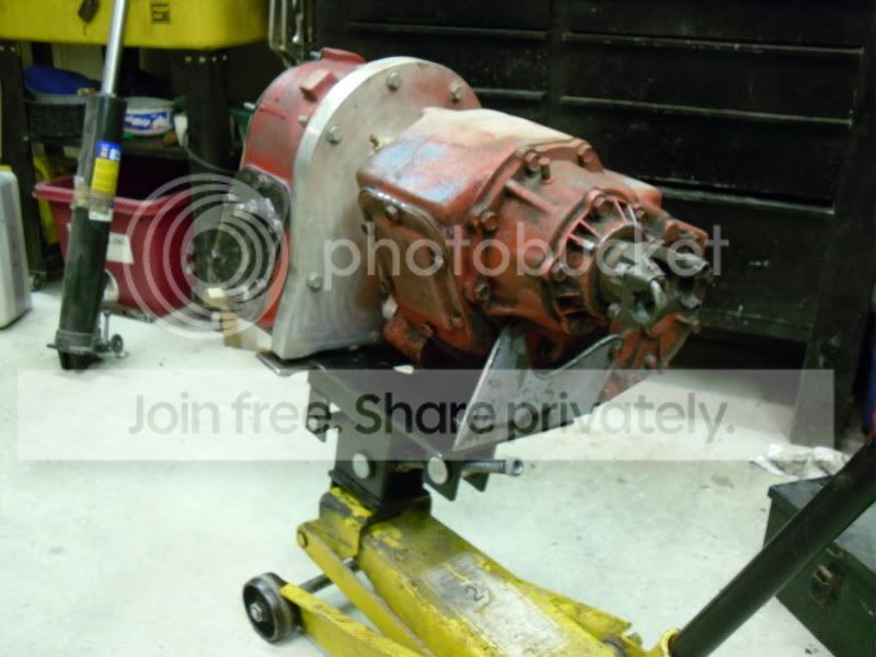

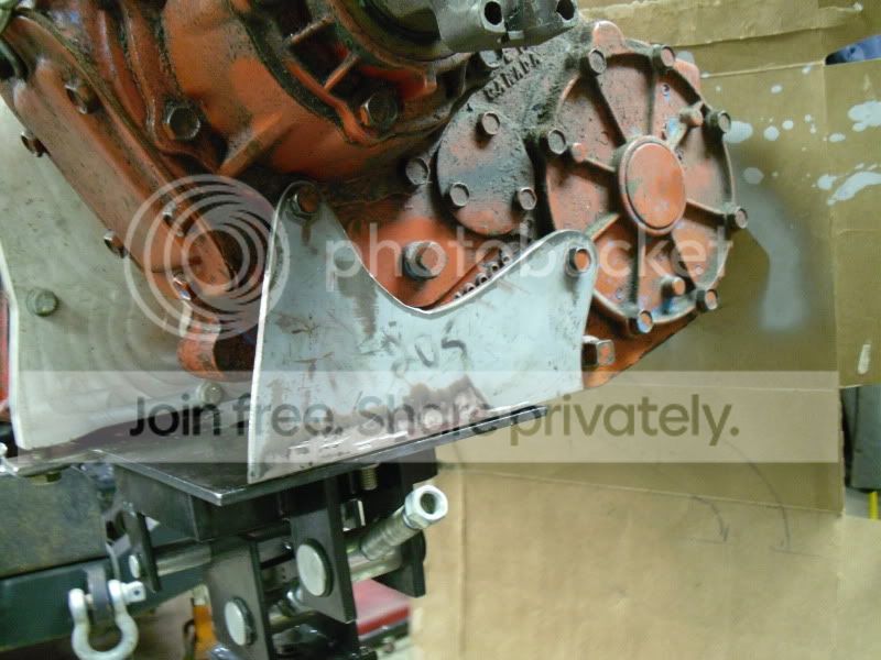

P.S. I have modified my floor jack with bracketry to support the unit to ease installation, and just in case...
G.M.H. (P.S. I have modified my floor jack with bracketry to support the unit to ease installation, and just in case...)[/quote]
Hows-a-bout a pic or 3 of floor jack mods ? Thanks !
It's actually a modified transmission adapter. It's bolted loosely to the jack so it can't fall off, yet it flops around a bit to make alignment easier.
