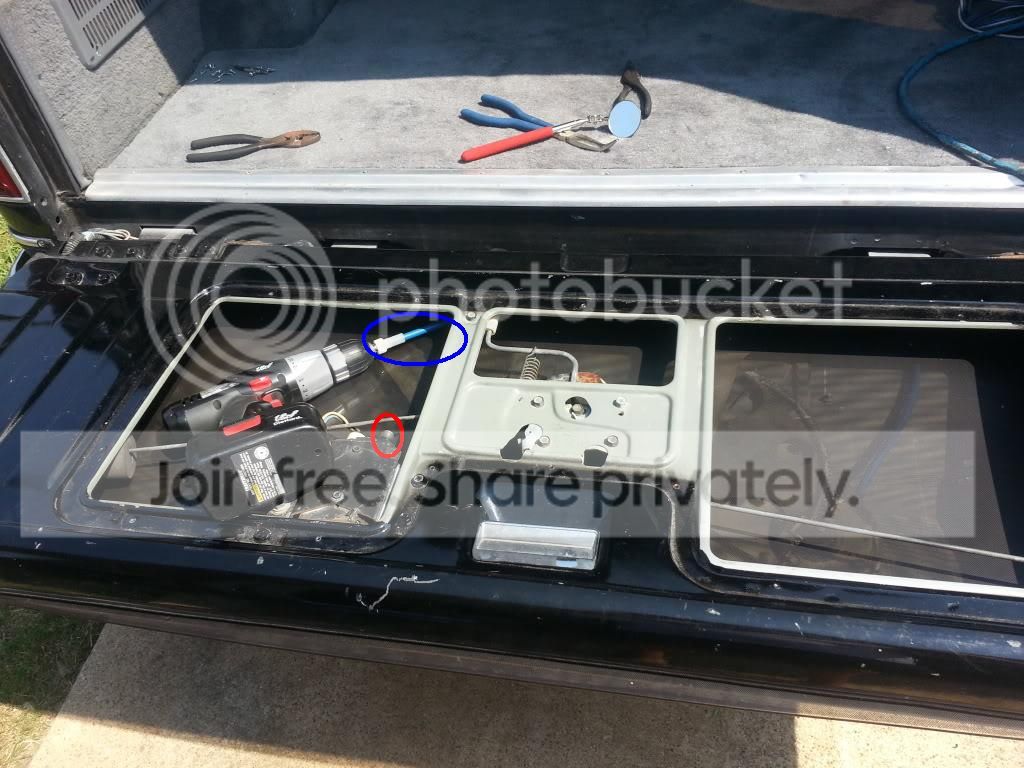

The red circle is where the cable connects to the motor.
You can follow that cable and see where it connects to the transmission at the top of the tailgate on the passenger side (lower right in the pic).
