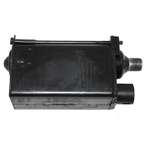

Agreed with above, the switch is the likely culprit and probably the easier fix too. I had some other issues on mine I just went through however. The truck has been sitting for quite a while, and the motor was seized (water leaking in through the back glass seal). I found this reman at summit, and it looked and worked great. Not cheap, but I was having some trouble finding them:
