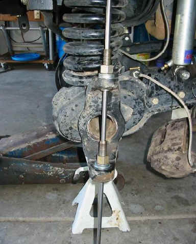

Your caster angle is basically the angle of this rod, compared to vertical, with the weight of the truck on the suspension:
You can measure it on the knuckle or maybe even tie rod surface if it's flat, compared to horizontal, but you can't really do it with the axle out of the truck because it depends on the spring curve, shackle length, etc.
To adjust it you need shims under the spring packs, a different shackle length or re-weld the axle C's. You could go to an alignment shop for the measurement and then buy shims to adjust from there.
