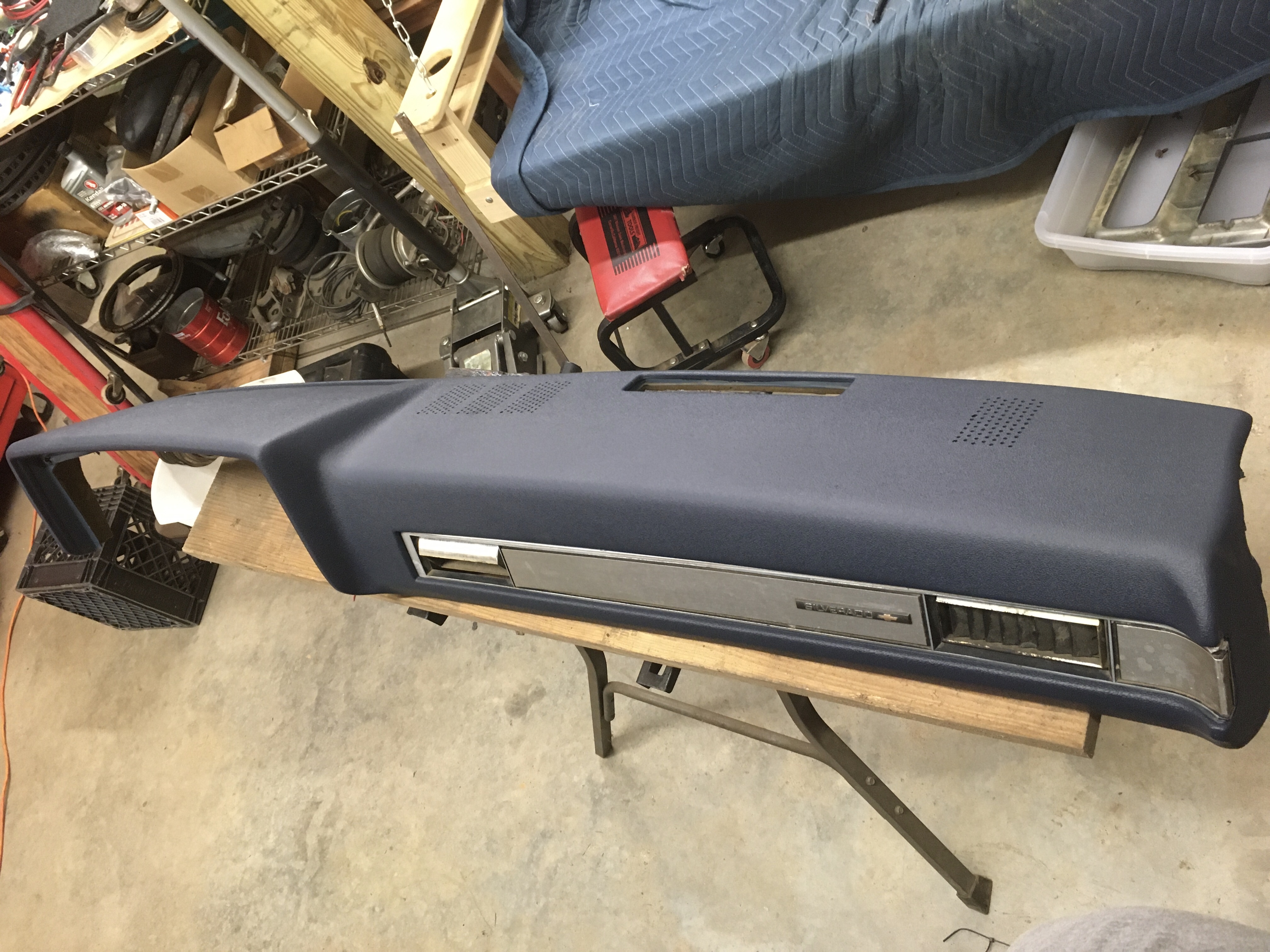

Surprisingly the coverlay actually looks great if you’re on a budget or don’t need the exact stock look I actually prefer the hard plastic. Looks more modern and it’s really durable and holds up to the sun. 4CE4CB91-4692-469E-BD84-E8516D4BAD69.png
I first chose Cheyenne pickup but it was too floppy and not oem shaped enough for me. Dashes direct brand is very not bad and I think the closest to oem available.
Still oem is the best and if able to be covered, the way to go.
