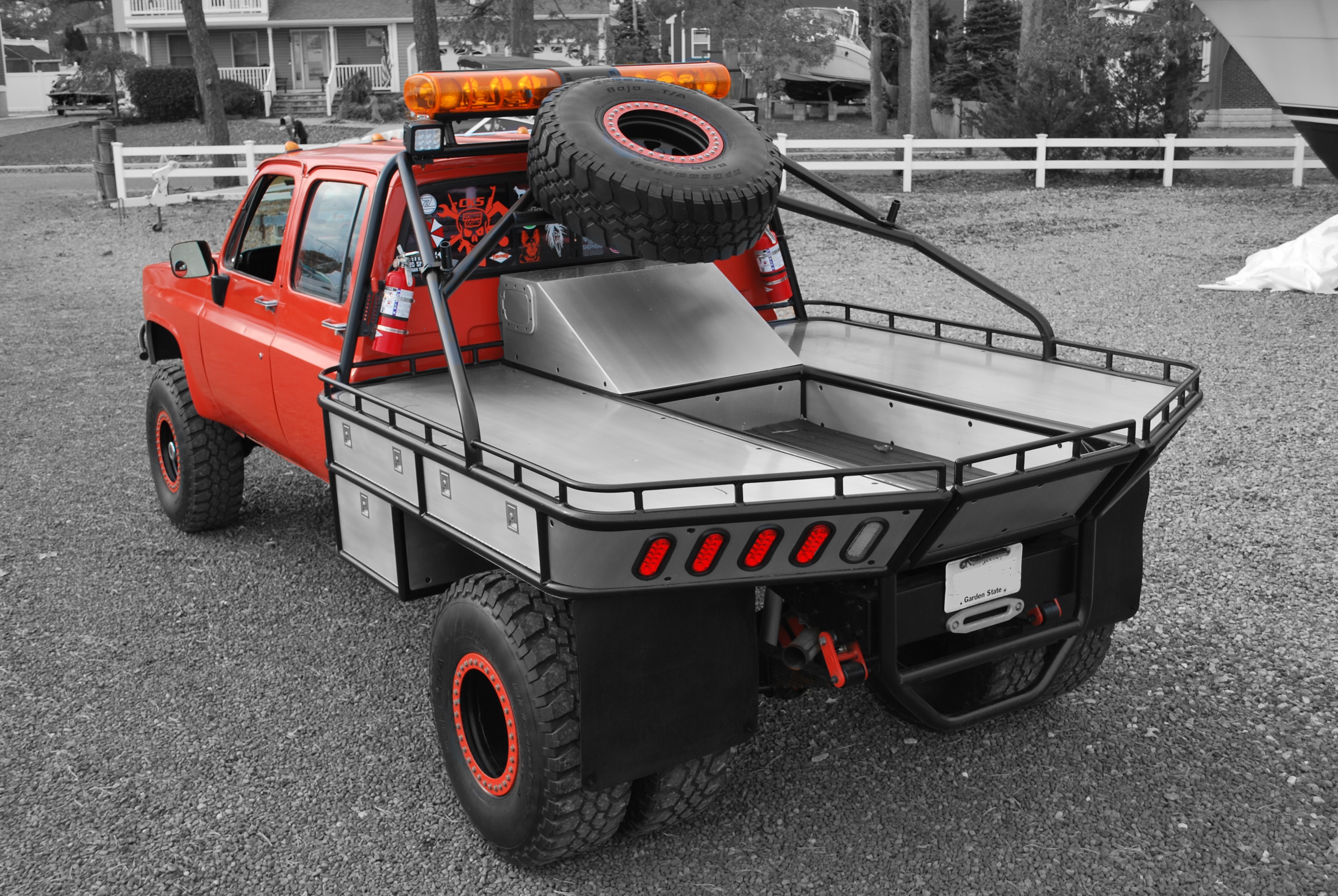

Hey everyone, it's been awhile.
I finally got my new truck body installed, which is aluminum. I cheaped out when I saw the paint quote. I didn't realize how fast it would look crummy with water marks.
I'm gonna clean it and shoot clear over it since I like the aluminum look. I've heard diamond finish clear is good for this ? I'm mostly looking for durability.
Thanks

I'm assuming pics are in order?
This is all I have, I'll post some more tomorrow.
I still need to find a way to clean the dirt spots without polishing it. The more I try to clean it, I just scratch the surface slightly. I might need to burnish it like Ryoken, or just paint it. I like it aluminum, I get some compliments and some weird looks.
