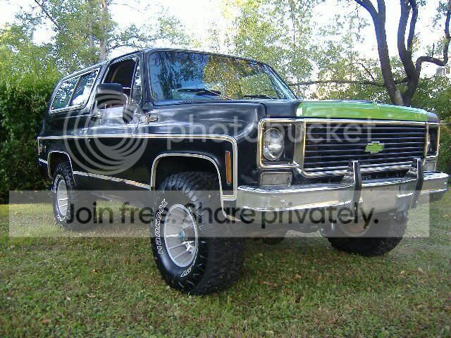

i used my factory hooks on mine...if you look close in this pic you can see them under the front bumper...i have the original factroy towing package on mine so ill use the rear hitch to hook straps to if i need to be pulled out backwards
I have factory hooks in the front aswell. I have bent them on my old truck though so not sure how long they will last. I am welding some ''D'' rings on my rear bumper aswell as getting a hook which slids into the reciever hitch.
You can just see them in the pic.
X2 I got the factory ones for the 70's trucks.
if you look closly you can kinda see em'.
