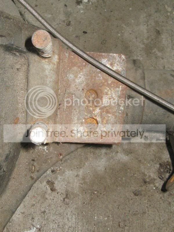

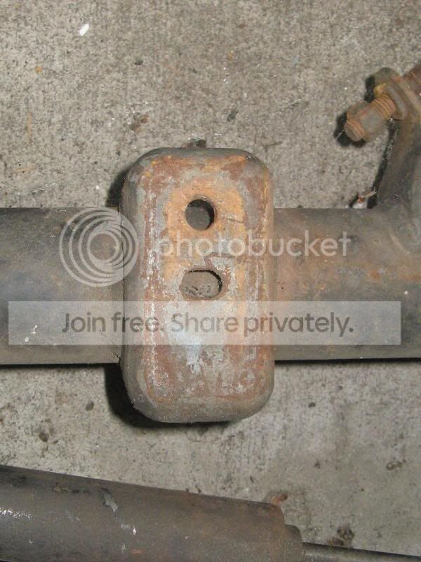

Does anyone have pics from redrilling their spring perches? I'm interested in using this solution but some pics of the long tube perch drilled would be particularly helpful. Thanks for all the input everyone.
Tube side
Pumpkin side
