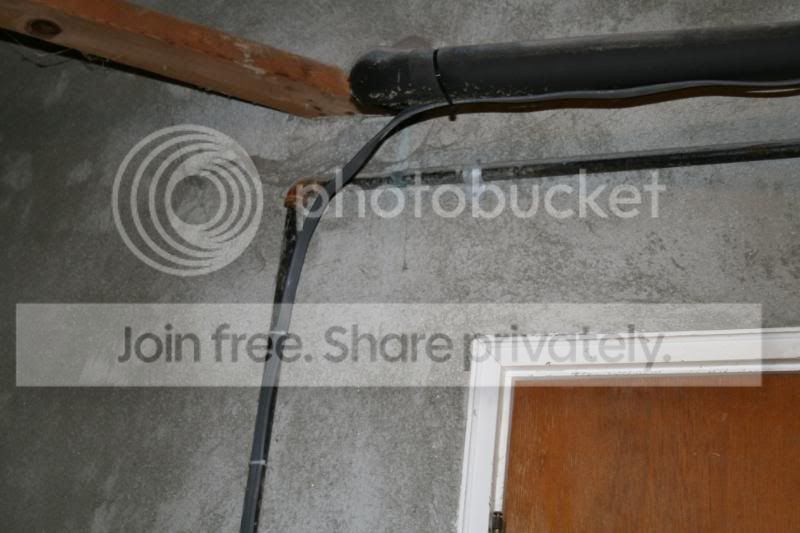

It's been in the garage the whole time taking up TONS of valuable space so I decided to move it outside the garage. Between my dad and I we lugged it outside, drilled through the wall and ran the air-line and wires back into the garage and into a hose on a reel on the wall...

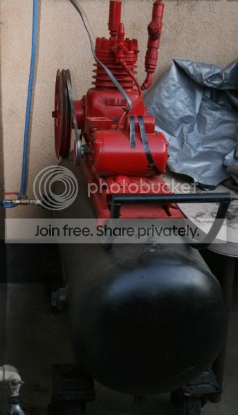

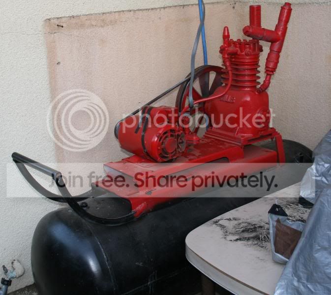

Here's some pics...

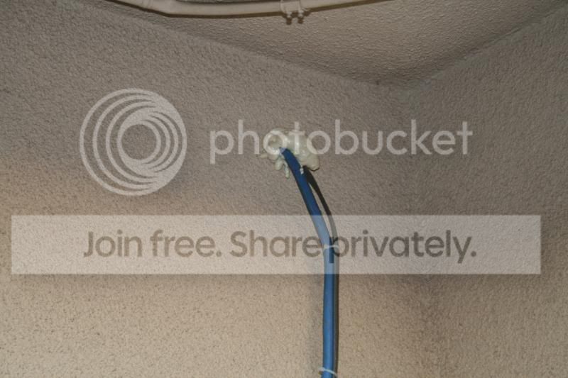

Luckily we have a corner outside the garage (but still under the roof for the most part) that we aren't around too much so it's not too much of an eye sore... I'm going to build an enclosure around the entire thing in the next few weeks. For now I just toss that silver tarp over it.
Now that the foam is set-up I can sand it smooth (this stuff expanded a TON).

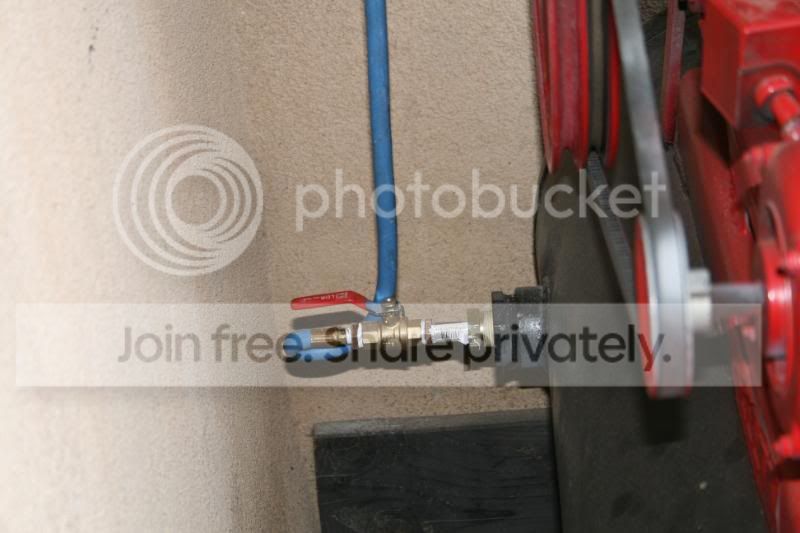

While I was at it I put a ball valve directly off the tank so I can shut the flow to the entire system off if need-be. The tank holds air like a champ so once it's full it'll stay full for a few days so this way I don't have to empty the entire system and at the same time I don't have to keep pressure in the lines unless I'm using it...

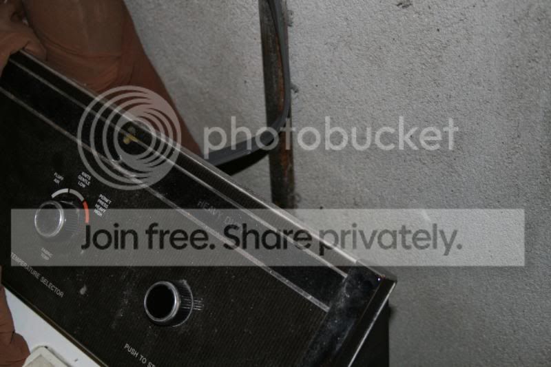

The wiring comes in the garage and drops down behind the dryer where the hook-up is...

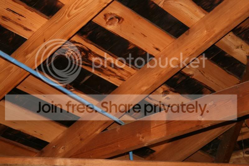

The air hose runs the other way towards the front of the garage...

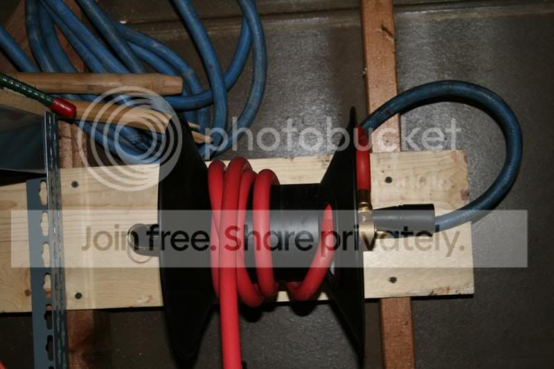

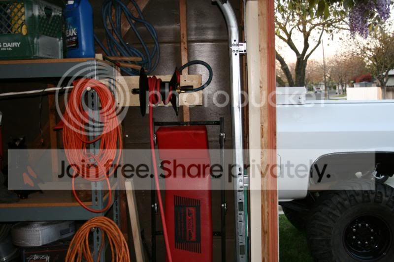

I mounted a reel on the wall so I don't have to mess with rolling up hoses anymore...

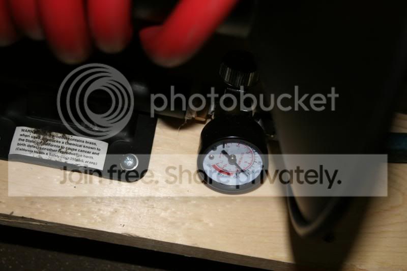

Oh, and I tossed a little regulator/guage between the hose from the compressor and the hose on the reel...
